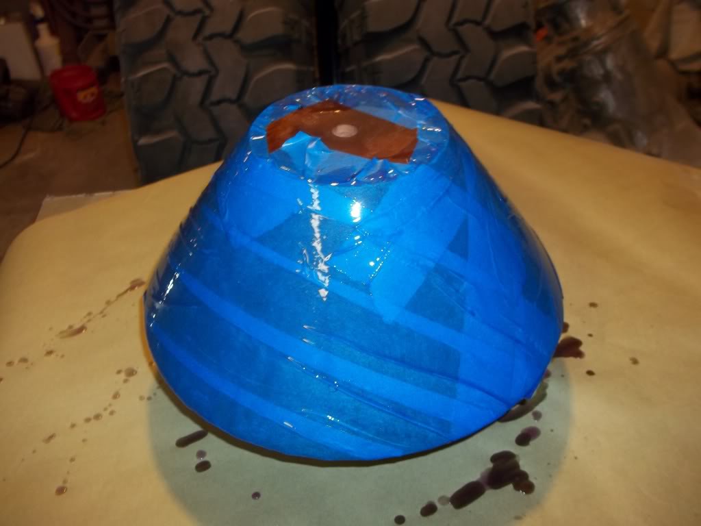

just to be the funny guy.. molded from, an actual salad bowl...

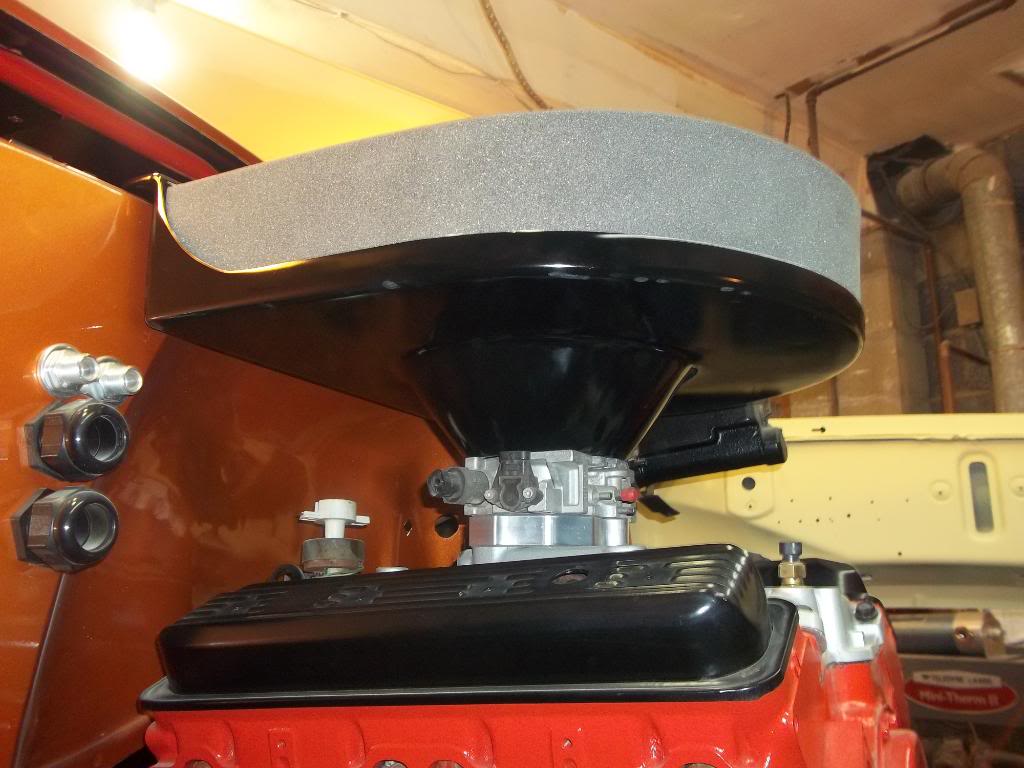

and for something actually a bit helpful... still run my old CFM Tech metal one, same as that Jegs, on Mutt... it actually does make a difference....
I took and cut the air filter base out almost as big as the bowl top . Been running one for years . Its now feeding my edelbrock pro flo 4 efi setup .
