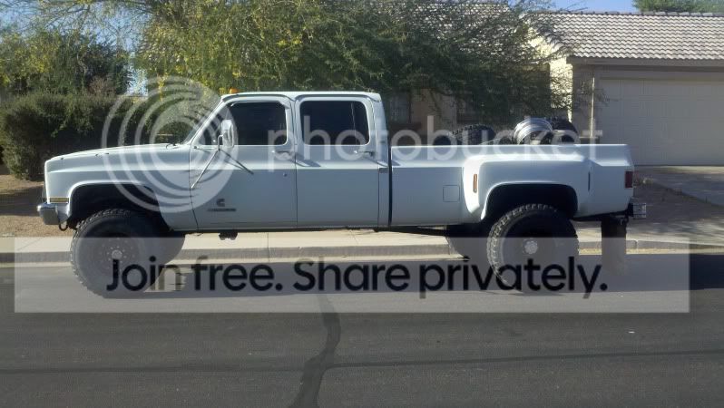

I don't have any close up pics but here are a couple side shots of my truck after my fender trim. I have about 5" of lift ,37's and a zero rate to move the axle forward 1 1/2". I did a slight angled trim on the front and rear edges of the fender.
Thanks. That's a cool looking beast. So do you have 5" plus the zero rate = 6", or 5" including the zero rate? Do you think that would be enough trimming to stay out of the sheet metal flexing?
5" includes the zero rate. I can still hit the inner fender with the wheels turned at full stuff, but it doesn't hit very hard and I don't hit it very often
