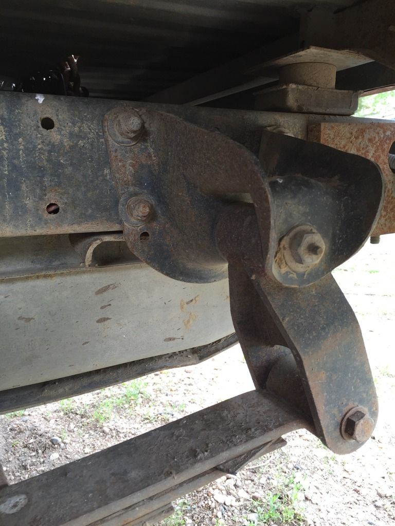

handloader90 Building! Joined Sep 14, 2013 Posts 2,665 Reaction score 1,053 Location Colorado Jul 5, 2016 #1 Looking for some cleanly removed front spring hangers to do a homebrew shackle flip with. Lemme know what you got.
82355 1 ton status Premium GMOTM Winner Joined Feb 4, 2009 Posts 17,238 Reaction score 7,904 Location Bradish Nebraska Jul 5, 2016 #2 That's a tall one. Martin
handloader90 Building! Joined Sep 14, 2013 Posts 2,665 Reaction score 1,053 Location Colorado Jul 5, 2016 #3 82355 said: That's a tall one. Martin Click to expand... The tall ones are the ones needed for the 4" of lift right?
82355 1 ton status Premium GMOTM Winner Joined Feb 4, 2009 Posts 17,238 Reaction score 7,904 Location Bradish Nebraska Jul 5, 2016 #4 Mine are not nearly that tall. Martin
handloader90 Building! Joined Sep 14, 2013 Posts 2,665 Reaction score 1,053 Location Colorado Jul 6, 2016 #5 How much lift would you say the short ones got you?
82355 1 ton status Premium GMOTM Winner Joined Feb 4, 2009 Posts 17,238 Reaction score 7,904 Location Bradish Nebraska Jul 6, 2016 #6 I also have a 7" shackle and a 1" zero rate. Around 5". Martin
handloader90 Building! Joined Sep 14, 2013 Posts 2,665 Reaction score 1,053 Location Colorado Jul 6, 2016 #7 Is that with 52" or 56" springs?
handloader90 Building! Joined Sep 14, 2013 Posts 2,665 Reaction score 1,053 Location Colorado Jul 6, 2016 #8 Also, did you do any kind if reinforcement like angle iron or anything to secure the bottom of the spring hanger to the bottom of the frame rail?
82355 1 ton status Premium GMOTM Winner Joined Feb 4, 2009 Posts 17,238 Reaction score 7,904 Location Bradish Nebraska Jul 6, 2016 #9 56" Martin
