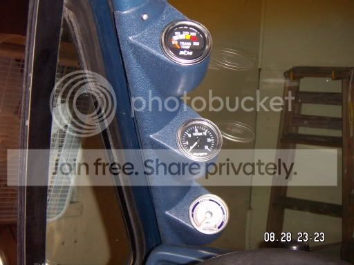

i made this....it's from a cherokee and it works great....
Here was my alternative to not finding a pillar pod. This is from a Mustang GT. I jus had to file the bottom some to get it flat. But it fit really well. I painted it Blue to match the interior, it paints really nice and easy.
A little off topic but i want close up pics of your dash set-up. I'm wanting to install Auto meter guages aswell someday soon. How did you mount them?
My dash? :confused:
Blue85 said:
I used a generic 3-pod one from ebay. It was really cheap. The angle is a little higher than ideal, but I can still read the gauges no problem.
Did you get my PM?
haha...sorry, just saw this...yeah i love the autometers. but they are pricey. they were in the truck when i bought it, but we did the same thing to my dads truck. wasn't too bad, a little triming and alot of patients for the wiring(not my favorite task) but it went smooth. just PM me with any questions and ill help you out man.
