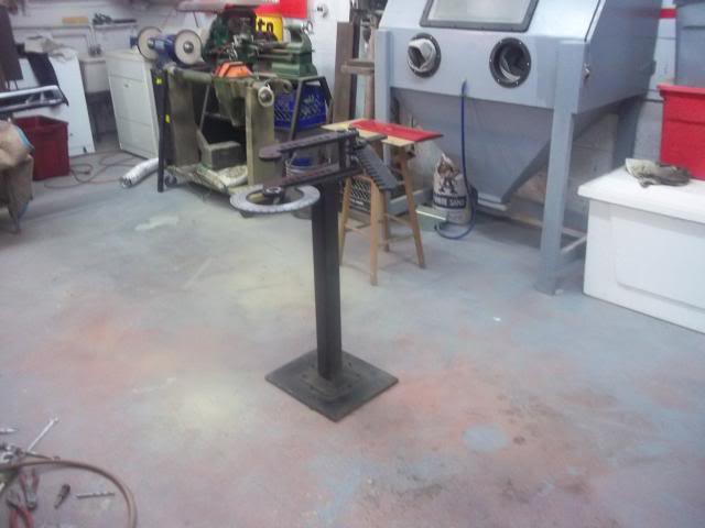

funny thing is, my concrete is questionable. and the stock base, bending 2", was too much and ripping the anchors out..
had to make this big fishplate to get that under control.... made it 45 degree clockable while i was there...
