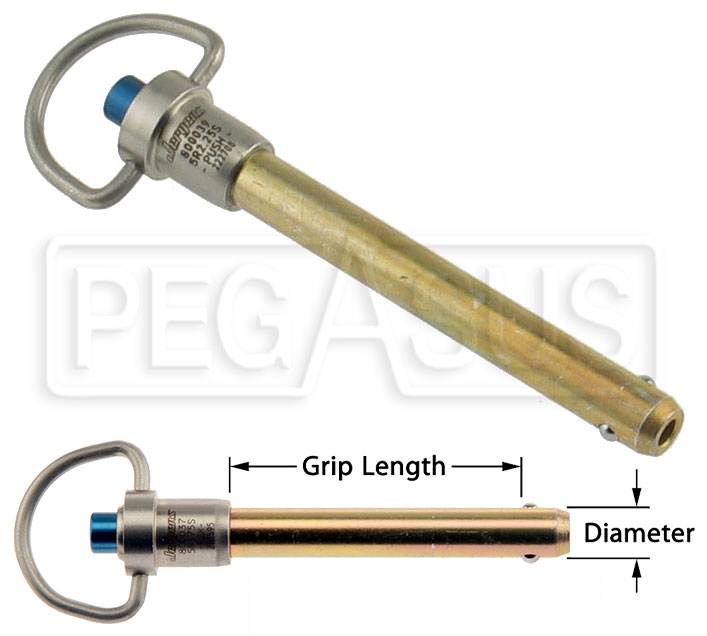

I am thinking of going with some design using these: https://www.pegasusautoracing.com/productselection1.asp?Product=3050
I would put a tight tolerance washer under the tub below the threaded mounting hole. I could weld the washers to a piece of steel, and weld it to the under-body. Then, just drop the pins through the mounting brackets below the seats, and through the bed. When i want to remove the seats, just push the button on the pins, and pull them out of the brackets. i will take a look when we get a day with no rain around here.
I think you are wanting to use these in a way they werent intended. I am pretty sure those are made to be installed in a shear position like the pic I drew, dont laugh:doah:
Just think if you were ever in a rollover then your passnegers would solely be relying on those little balls to hold the seat into the truck and not the hardened shaft.
After I read my post after i put it up, and looked at the photos of the pins some more, i thought the same thing. :doah: I do believe those pins were meant to be implemented in an application where they could withstand a shear force, rather than in a position where they would encounter a lateral pull and have to rely on the balls to hold.
Oh well, time to rethink the project.
