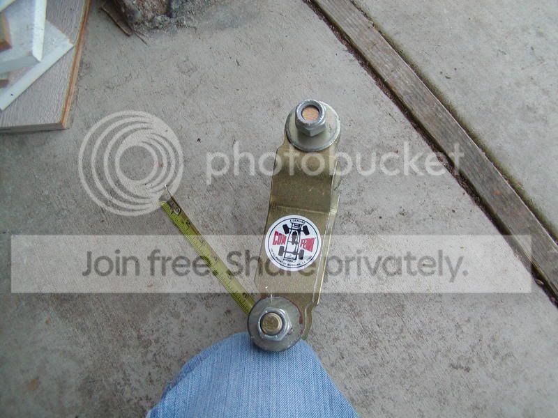

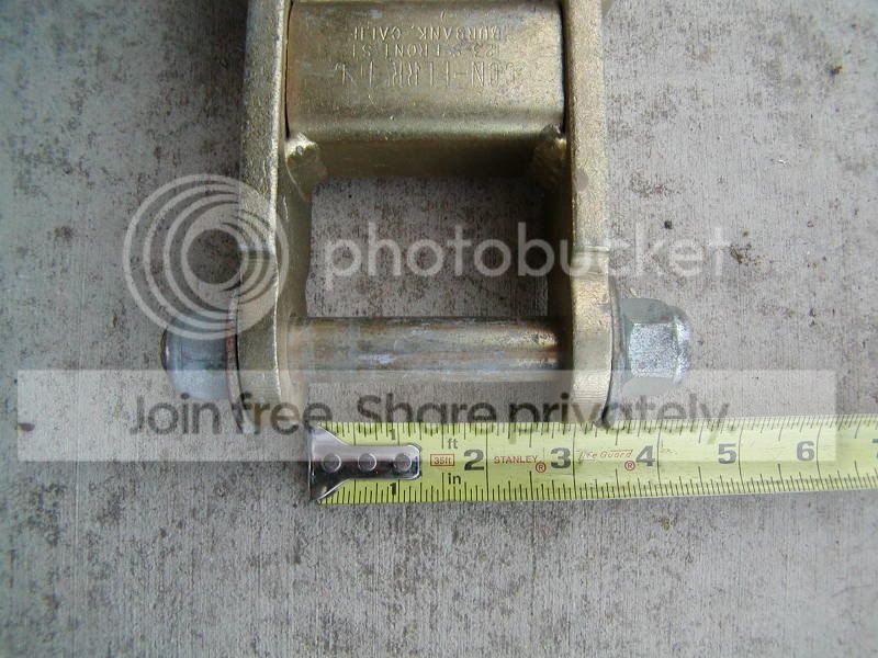

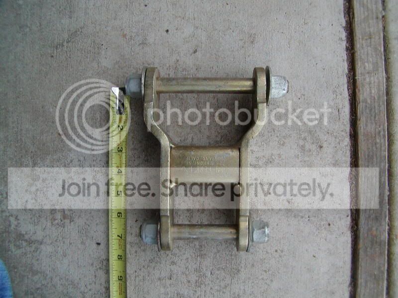

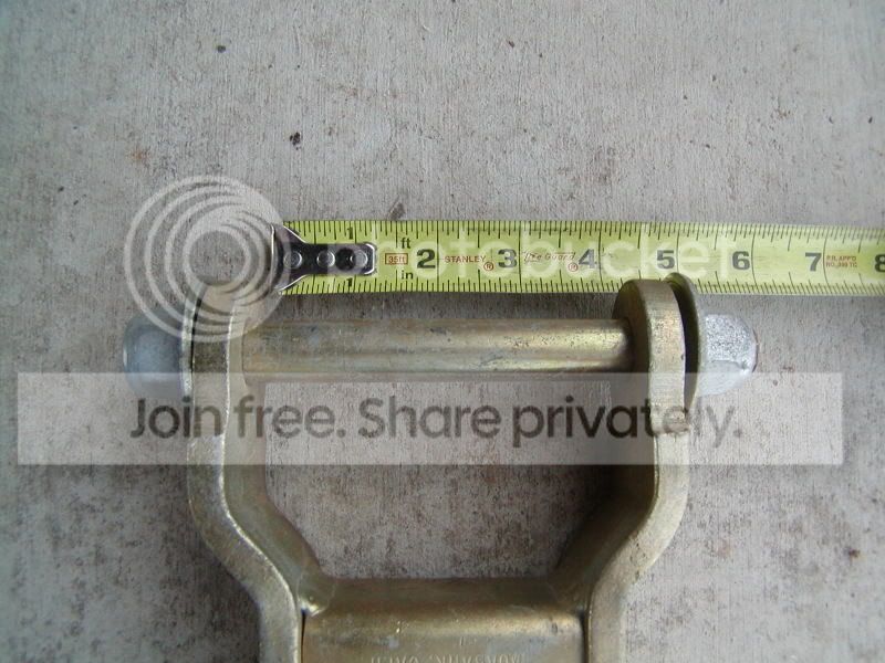

So I've been doing a lot of thinking about my '79 K10 project I'll be starting this summer, and went for a looky-loo through my dad's parts he's got laying around. And while searching, I found these Con-Ferr lift shackles meant for a Toyota rear.
They're 6.5" long, and will fit a 2.5" spring, but here's the best part: the top is meant for a 3" spring. So I took a look at my truck's rear 52" springs, and got to thinking again... I can do the L-bracket trick on the front spring hangers, then bolt up these shackles to the factory upper hangers with the narrower springs. Then alls I gots to do is get some 56" springs (or 64") from the parts yard, along with a DIY4X shackle flip and 7.25" shackles, and I'll be set suspension wise on my K10. So what do y'all think? :D

Just looking at it, it looks like it may not... and if it does, it might contact durring only minor travel. But it's hard to tell looking at it on a monitor.
It's worth checking out. I hope it will work for you.
Yeah, from the pics it looks like there's 1.5" of clearance from the center of the hole until it steps. I was hoping it would work too, because I'd basically have a free 52" spring swap on the front end. Oh well, I've got until summer to sort things out anyways... :(
Well, at that end of the shackle (closest to the pivot point) it shouldn't need a tremendous amount of travel, but it will of course need some.
