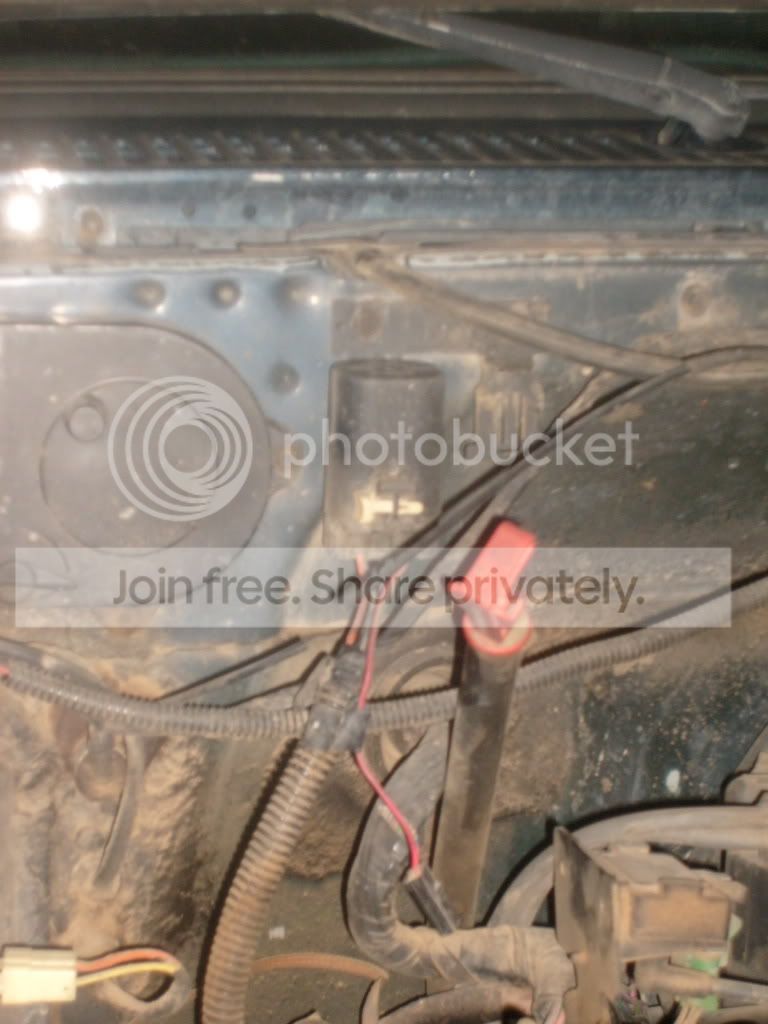

I was poking around my wiring and was reminded of some pigtails that AFAIK haven't been hooked up since I bought the burb. Can anyone tell me where they are suppose to go?
First one comes from a switch or relay type thingy on the middle passenger side of the firewall. It looks like it should go to the bracket next to it, but I don't just want to start plugging stuff in without knowing for sure. Anyone?

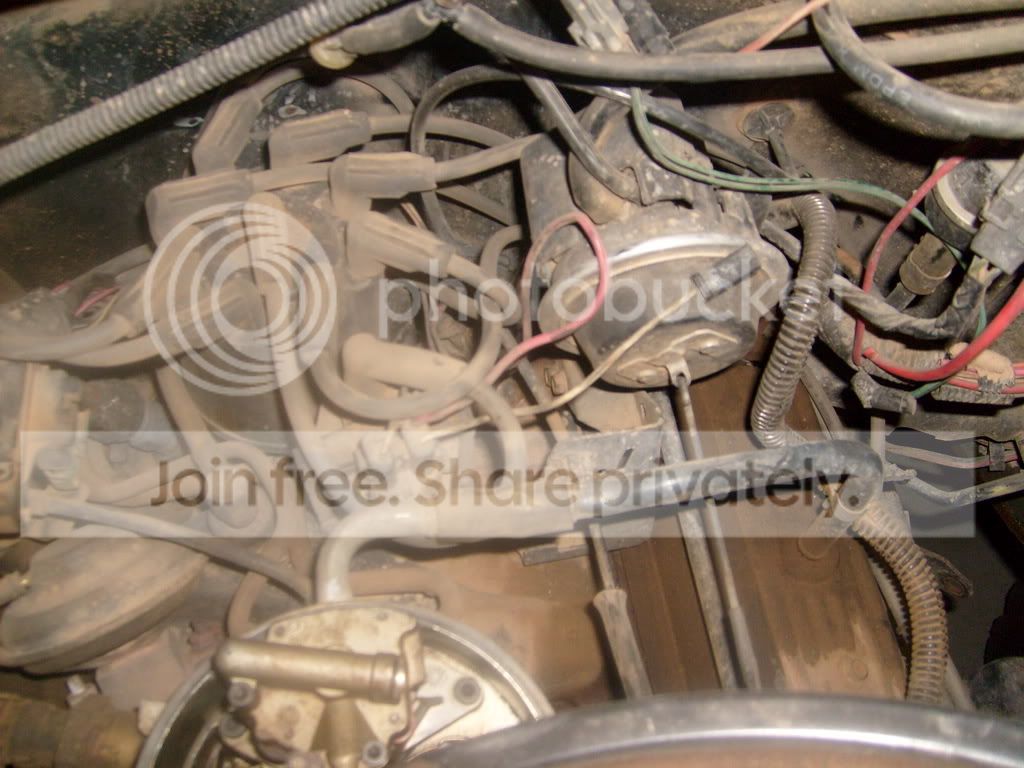

Any this one?

The first one Im not real sure exactly what it is. I do know its comeing off the fuel pump relay, but I have never seen that wire conected to anything on any trucks I have worked on.
The second one is for a tachometer conection. It is the signal wire for your RPM's.

the first is your 12v bypass for the fuel pump relay (run power to it to eliminate the relay)
and tach...
x2, the first one you can put 12v on the wire and it will power the fuel pump, incase your relay goes bad, and the second is the tach lead.
Thanks guys. I appreciate all the responses. Now I know where to hook my tach up when I get one, and what to do if my fuel pump isn't going. Good information, thanks. :D
