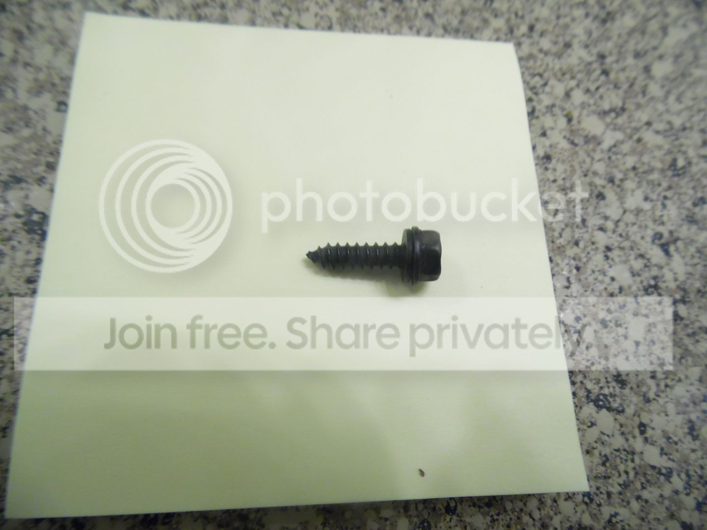

my garage is a total mess and Iissed placed my dash screw for the front of dash pad, as usual!
So could anyone help a guy out with what size they are and length? 87 K5 tbi
I just took one out, dunno how to describe it though. lol. It has a 9/32 hex head, and has a bit over a half inch of thread.
Gives me a heads up. I thought they where Philps head or that only pass side of dash? I at least know where that screw is lol.
These were along the dash pad, right above the glove box door.
Yup. The ones that come in from the sides, that you have to open the doors to get to, are larger philips head screws. And I can pretty much guarantee my truck has all original stuff.
