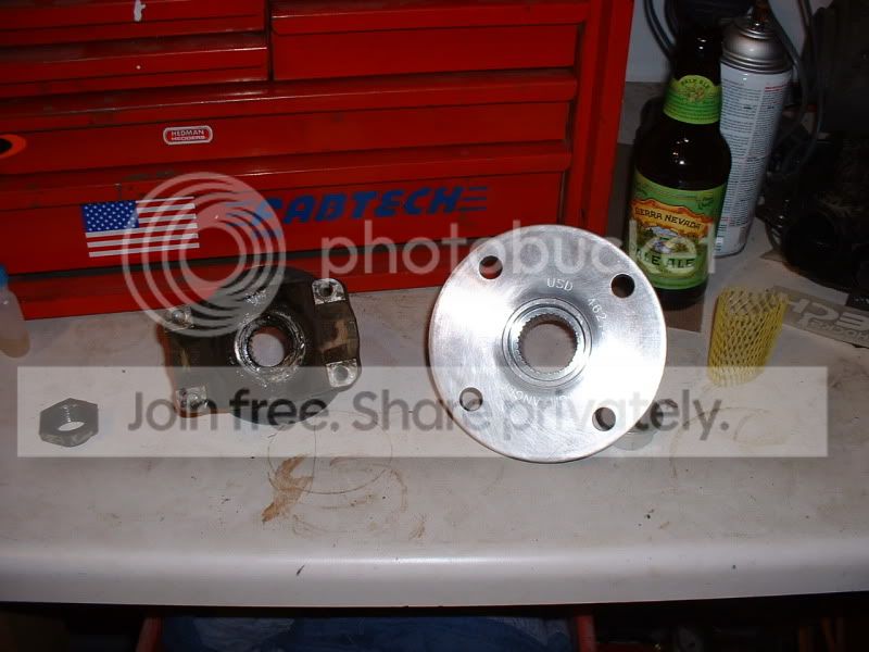

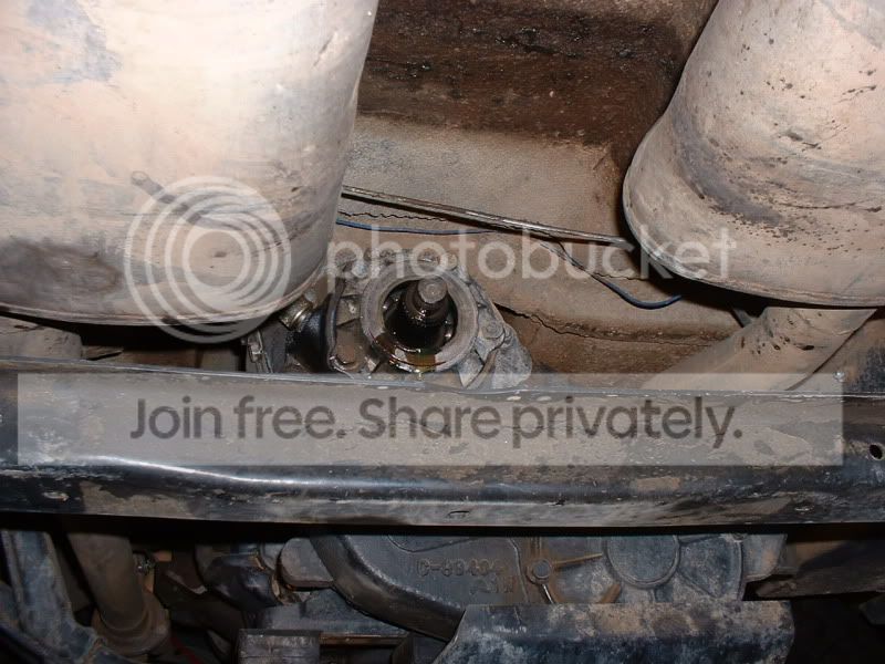

Old yoke removed from transfer case -
Old yoke vs new flange -
and again -

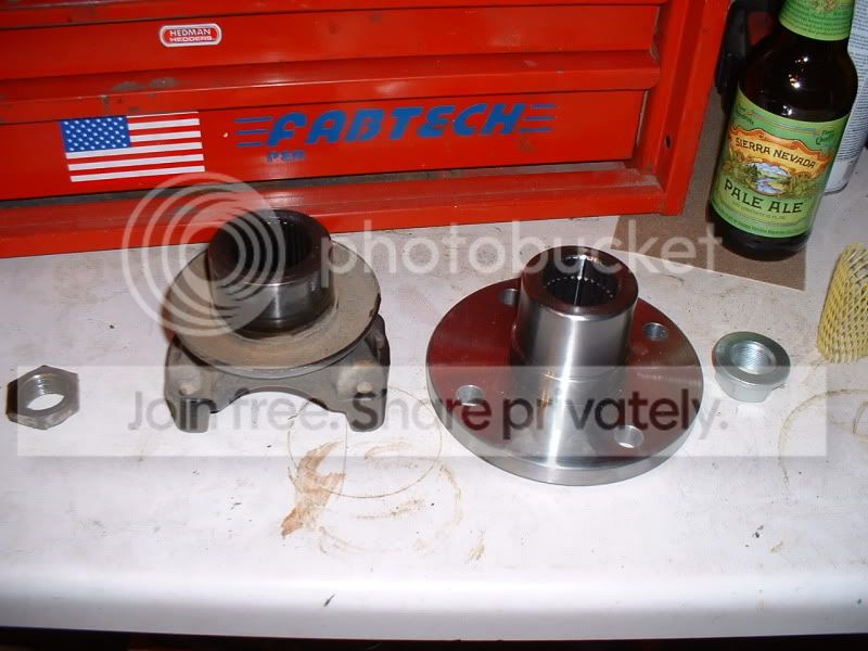

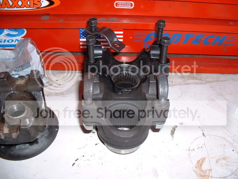

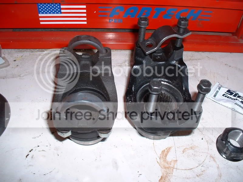

1410 strap style yoke vs. 1350 U-Bolt Yoke BTW there is a reason the strap is hanging off, it doesn't fit the yoke.
Again -

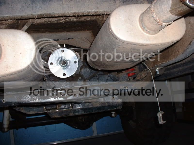

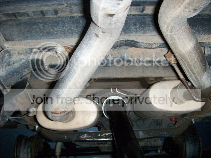

New Driveline -
Flange installed -

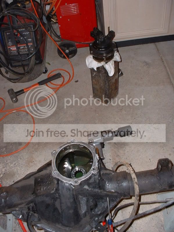

Pinion Removed for re-installation of the yoke I really wanted w/U-Bolts.
Now the next problem, the 1 1/2" socket to remove the 1410 yoke doesn't fit inside the 1350 yoke. So a friend has my SK impact socket on the mill right now to remove 1/16 of an inch from the extrior of the socket. Hope it's still strong enough.
There is a reason people just use shims to adjust the driveline angle - the're a freakin' pain to remove.

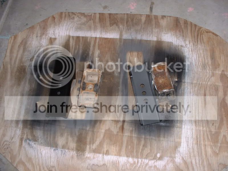

Old removed after about two hours of grinding vs. new to be installed.

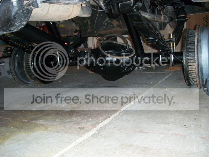

I've got the whole thing mocked up and ready for installation and permanent weld of the perches etc. but i have a question: In your opinion, how much compression of the slip assembly would be acceptable on a '72 K5 with 8 Inch Skyjacker suspension lift, Offroad design's shackle flip DIY4X Shackles and no blocks? How much compression does your's have?

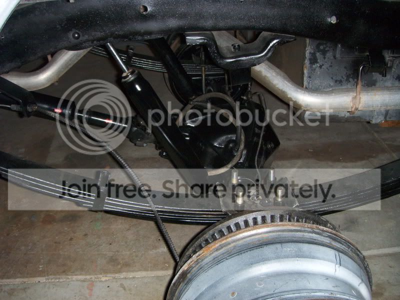

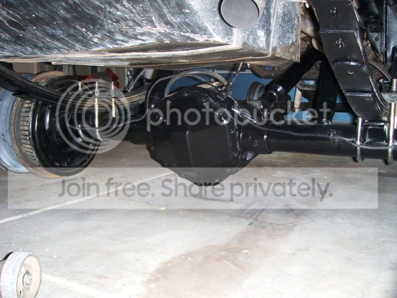

Almost ready for bouncing

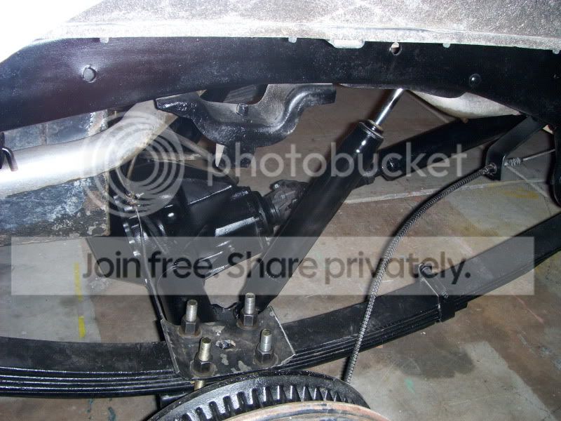

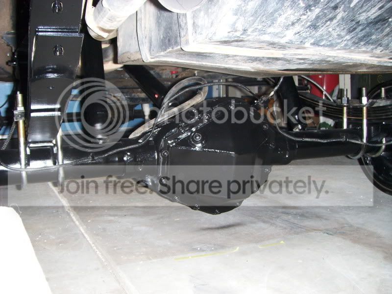

Tuesday welded new spring perches and primed and painted. Installed and ready for testing. Rims are required because I cannot get her into garage with wheels and tires installed. Still need to bleed the brakes and attach vent to floor.
Driveline angle 19 degrees Axle 17 degrees at rest.
Next project is the gas tank - the diff hits at full flex.
