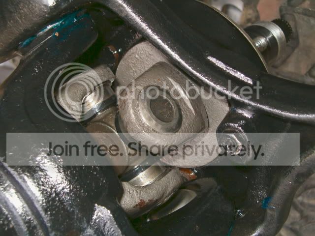

Lower kingpin question. Does this look right?
munepit
3/4 ton status
May 6, 2009
5,974
186
Bakersfield CA.
Something looks weird. Like there is a gap when the lower C in in.
Drivers side.
I think your OK Jeff, mine looked the same "tilted" as yours does.
why do you have the upper rubber seal in the lower dust cap to C ?
here ya go order of install.
lower =
empty "c"
r=tin dust cover dome up . I like little rtv to seal it to "c"
race cone section down . press up in .
bearing
seal is stepped so bigger half will go flush or just inside the "c" .
lower pin once knuckle is on .
upper is king pin 500-600ft lb spec
black rubber seal gm/dodge or ford
knuckle on / lower king pin in and floor jack to hold all up/tight
upper bushing . new there cheep or upgrade to bronze/ampco metal ones .
upper spring index washer then spring . or upgrade to crane off road spring eliminator kit . big urethane bushing and shims in kit ( if needed I didn't ) .
then gasket on top and arm /cap and bolt all down .
:haha: ha ha. Crap. I looked for the upper seal for an hr. That's the way it came when Iunpacked it. No frickin wonder why iI couldn't find it. I'm an idiot!!!! I had to use the old upper seal. And I even put that in upside down. Stupid. I was looking at bellavista and it did not show the lower seal. I was wondering why Iput that in.
And don't forget to put the studs in the knuckle like I like to do before installing it.:whistle:
