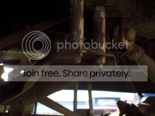

    first please reinstall those spacers back the way thay came stock. doing what you did puts extream pressure in that spot of the frame rail. pics have been posted in hear of the damage when it goes bad.
    second the more you drop the tcase mount the more angle it puts in the cv head. so you will actualy make it worse. 4" kit dosnt realy need a tcase drop. unless you have 4 speed combo as its the shortest one of all.

    Heres how not to do it.And remember kids don't try this at home.:D
    [​IMG]
