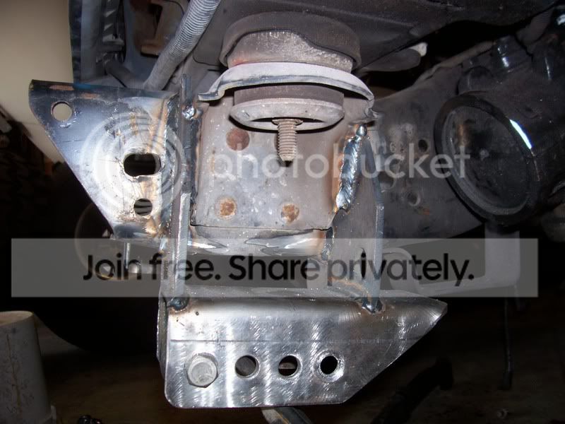

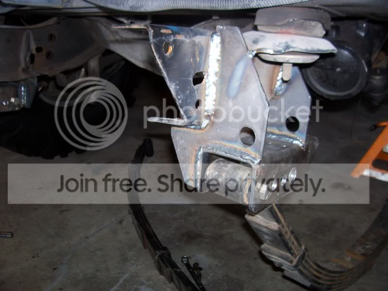

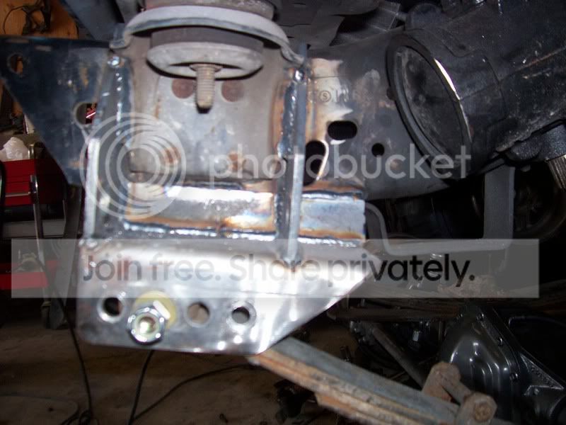

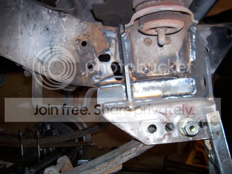

Didn't you build some lift into your hangers when you made them?
Hey could I get somemore pics of that hangar you whipped up? I'm considering doing the same with kurts weld on hangars since my bumper is in the way of B52s and the traditional bracket method.
