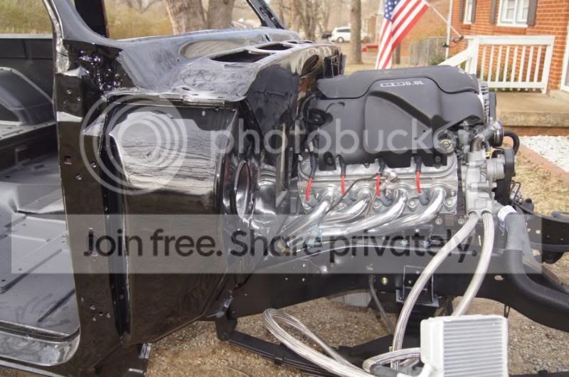

i am putting an LQ4 into my '80 k5... the frames are identical.
i used street and performance headers... they are a bit above your budget ($650) but they fit with NO mods what so ever.
here's a pic.
they also come with 02 bungs.
but for a woods truck, manifolds would be the cheap and non flashy way to go, for sure.
i've also heard f-body manifolds are the best manifolds to use. (least frame mods)
that looks sharp in there! any other issues you had or was it pretty a pretty sooth install?
headers fit like a glove.
only issue with fitment i have had so far were my engine mounts.... my solution ended up being brand new engine angle mounts from TNA, lower competition mounts from ORD, LS adapter plates from DIY4x, and I had to weld my ORD mounts to the TNA angle brackets.
