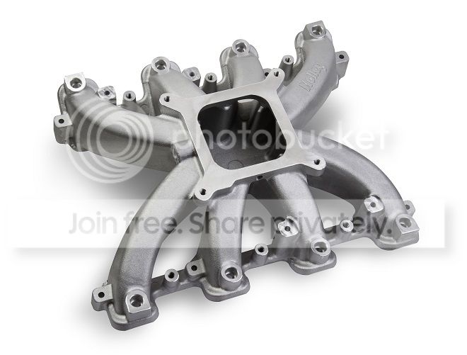

ok, I was curious whether there where any LS intakes that had the throttle body up on top as opposed to the common up front ones...
I knew there where companies making ones like that for carbs up on top... but I'm looking for one set up for MPFI, that you just have the throttle body up top...
started looking around and saw this holley offering that is supposedlely a carb one.. am I nut's or aren't those injector/rail holes on this?
http://www.holley.com/300-137.asp

answered my own question.. helps if you look at the pdf... :doah: :haha:
"this product is intended for carbureted, throttle body EFI or port EFI applications.."
The real key here is that that manifold comes on at 3500rpms... I wanted to do exactly what you're talking about for the street truck since its got a cowl hood on it but I couldnt find an LS low RPM manifold for a 4 barrel TB.
Ive basically decided Im going to run an edelbrock tall manifold and mount an airbox similar to the WS6 or c5 vette airbox over the manifold so its sealed or at least in the cowl.
2500 to 7 g's... being a single plane, that's not surprising..

here's another single plane from mastmotorsports

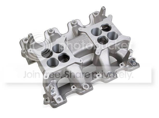

maybe this is the rpm answer... convert a dual plane carb one to mpfi
he!!, it's got the boss's in the runner to do the injectors already..... :popcorn:
that would be the way to go I think, sheetmetal intakes are crazy expensive!

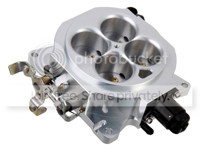

There is a company that makes a square bore to standard throttle body adapter. I just saw it when googling around for an intake manifold.

I'm really not worried about getting a TB on.. as sweetk30 showed, there are ways around that... rpm range, and getting dry injectors in are another story..
those last 2 setups I just posted look dual plane to me, same runner styling as a performer, etc...
I don't know, is the stock style considered a single plane? I would guess so, just long runners... looks kinda like a tpi intake...

that dual setup I just posted looks dual plane to me, same runner styling as a performer, etc...

The truck intakes are a "bottle neck" aimed at improving torque. Ive never really heard anything about guys "loosing bottom end" from any factory intake manifold. Or even after market for that matter. It seems as though with these motors its just stuff more air in so you know it has enough...
Kind of a theoretically bad way to look at it but every dyno shake down Ive ever read on LS builds from mild to wild it always goes truck -> LS1 -> LS6 ->after market. The curve has gotta move though. There has to be some point that the low RPM velocity is sacrificed for high rpm flow. I would be willing to bet the victor would have a better/lower rpm kick in with injection rather than carb. Theres really no reason for a dual plane with fuel injection...
right.. so I'm curious why that holley is listed at 2500... maybe cuz the runners are so short compared to stock would be my guess...
