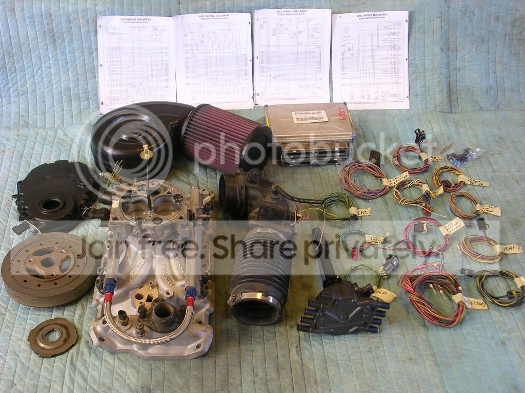

I'm starting to get my feet wet with the LS PCM project. I'm working on converting an old school SBC to sequential EFI. The software is expensive!:eek1: I'm leaning toward EFI Live software. EFI Live offers a demo version.

So here is an update on my LS ~ '0411 VCM progress. The list of things done is longer than the list of things to do.:smile1:

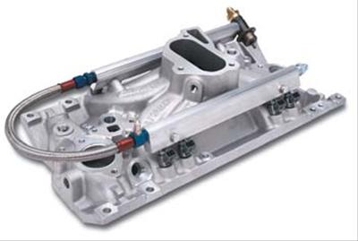

I'm learning more every time you do. Next spring, I'll be 500$ a month richer, so I'm planning on efi'ing that Vortec with the Edelbrock 3505 multiport I've been sitting on since my divorce......I can't wait. I'm already drooling....Thanks for all you do. :thumb::bow:
3505
