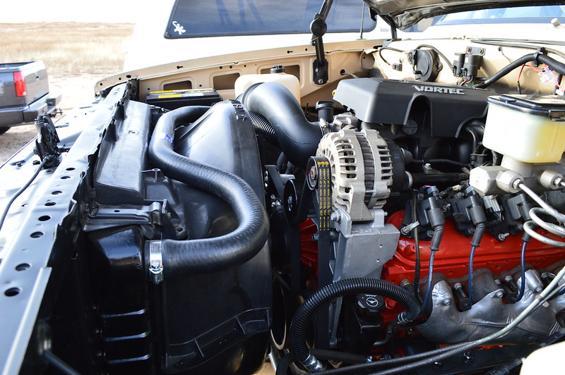

Contrary to popular belief aftermarket radiator$ and instrument cluster$ are not required to do a Gen III swap. This K5 here was just recently upgraded to the larger diesel 81-91 diesel radiator along with the factory shroud. Looks like it came from the factory this way...
My 8.1L Suburban with stock squarebody diesel radiator and shroud. Same goods that the K5 above recently was treated too

Looks like
you're running a mechanical fan? Cant tell in the pic. I just learned, I think, that my motor (03 LQ4) came with a mechanical fan. Not necessarily a problem, I was just unaware.
Looks like you're running a mechanical fan? Cant tell in the pic. I just learned, I think, that my motor (03 LQ4) came with a mechanical fan. Not necessarily a problem, I was just unaware.
