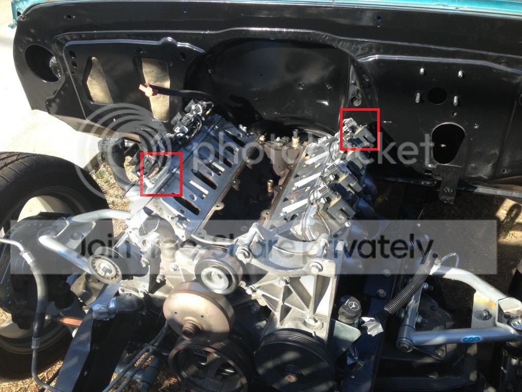

Most cans, including mine, have one inlet and one outlet. My engine has what appears to be two ports, one from each valve cover. Neither seem to have a PCV in line. So do I run a "Y" fitting so both of these lines enter the catch can and then back out to their respective intake ports? Isn't there suppose to be one suction side and one vented side? Like how my Blazer is. Now, the cool kids run the LS6 valley cover with upgraded PCV system. This by itself is an improvement, but in conjunction with a catch can is best. However, I don't feel like spending money on an LS6 cover. (nevermind I just sealed everything up with new gaskets) Just running a catch can is better than what the factory did.
Here are the two lines. Can anyone identify these nipples? :D
I could be wrong here, but I thought I read somewhere that the PCV valves were integrated in to the valve covers.? :dunno:

Passenger side nipple is the air inlet and should have a filter(or be hooked to the intake tube) drivers side is the pcv valve and should go to the catch can,then the catch can is plumbed to the intake manifold.
Oddly enough, this port had oil in it too, just a little though. It enters between the TB and intake, so there is actually a cutout in the plastic for it and the O-ring gasket seals it. The placement almost looks like it would have more vacuum than pressure, much less staying neutral so it can suck into the crankcase. I'll see if I can mount small filter on it and cap off the intake.
