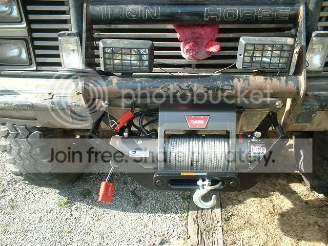

Check out this thread! Looks great. http://coloradok5.com/forums/showthread.php?t=259738 I sent you a pm on Pirate.
that looks like a solid winch mount. i have a front hitch mount with a receiver type winch. that way i can take it off when im not using it.
heres a pic of the set up i have

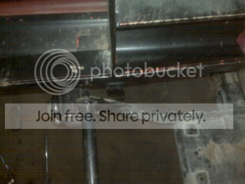

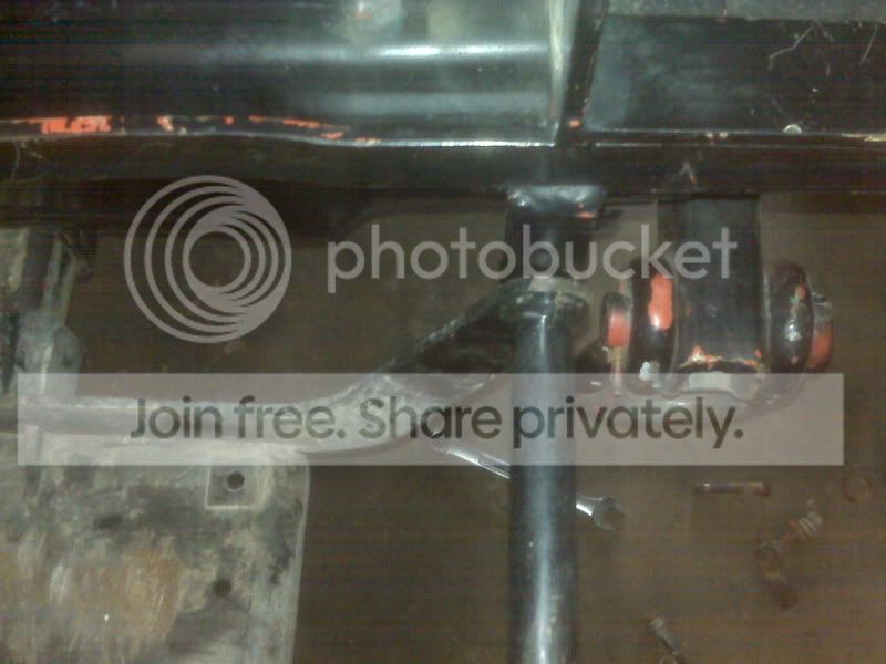

so basically the problem im having is the handles on that thing are way to wide to slide in between the bottom portion of the military grill guard.
What about just relocating the handles? Maybe more verticle? Just cut and weld. Would be a quick and easy fix for the winte and if you wanted to make a different mount later you could.
i think thats the way im gonna go. if i do a extension to do it properly the winch is gonna sit out at least another 8inches.
basically i need a inch and a half to get it all the way in. might as well hack up the handles :(
