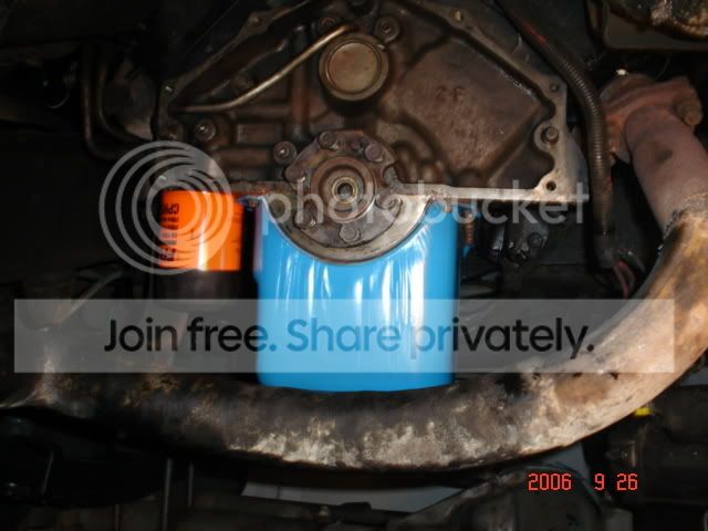

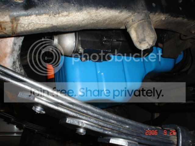

Finally not covered in oil...
Here you can see the oil caked crossover pipe...
Rene
