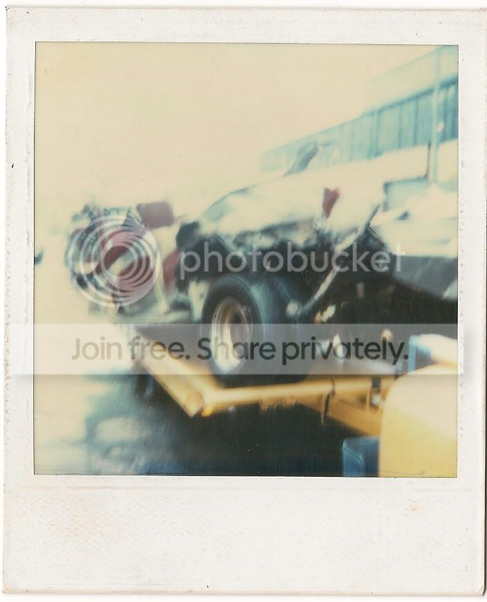

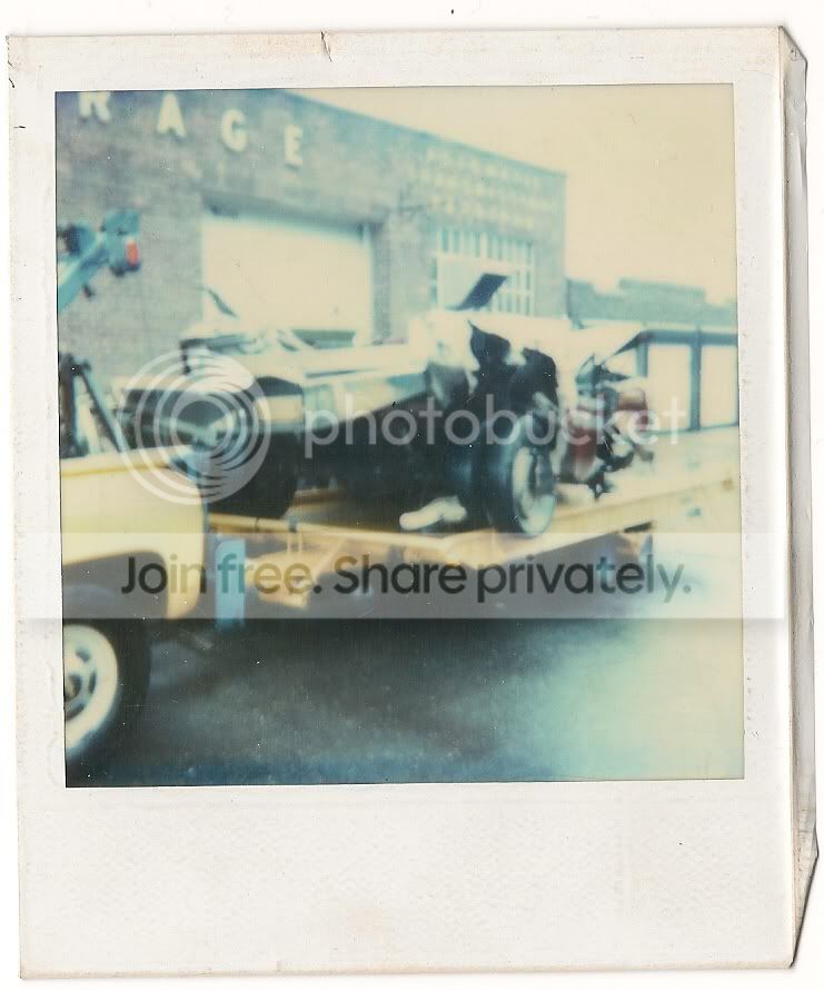

here you can see my 4,500 lb flatbed trailer on my pintle that was welded to the rear bumper/bed assembly. the mess on it was an F-350 dually that lost control with a goose neck two car carrier and two cars.....witnesses stated he couldn't stop in time comming around the curve. he had no comment as he was dead. the family of four in the car he hit all lost their heads too........that load was heavy enough for my C30. 292, granny low and 4.56's.
and my mistake, whilst i was pontificating in my first post was i thought a M1008 was the Blazer :doah:....now i know the difference in the designations. happy trailering, Bill
