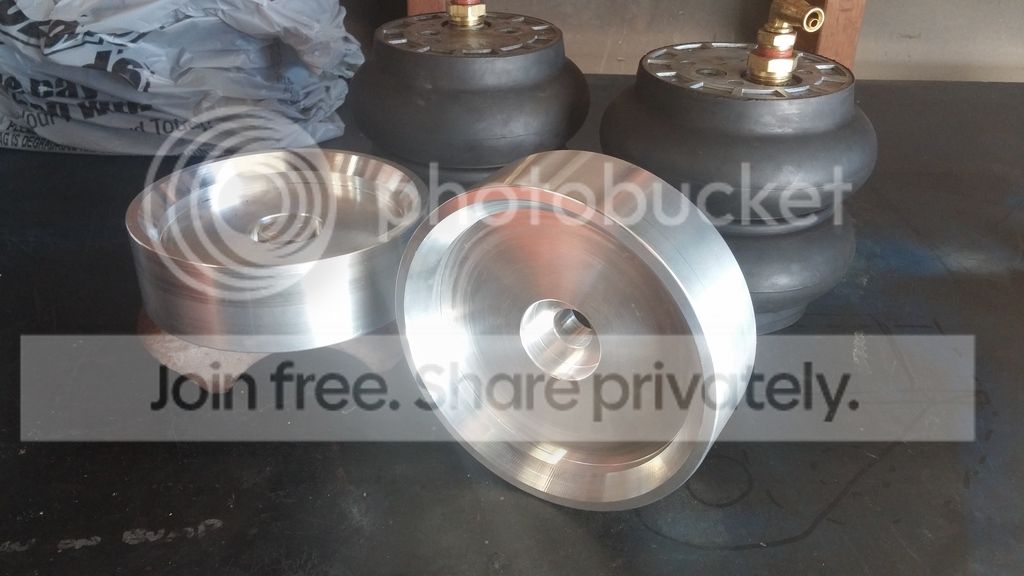

The guys I work for are really cool and I don't take advantage of the equipment available for personal stuff very often but when I need to make something it's nice being able to just make it happen.
I ran down on a Saturday morning when I was installing the air bags on the back of my Dodge and machined these cool aluminum cradles. They bolt to spring perches that I welded on the axle and catch the bottom of the air bags.

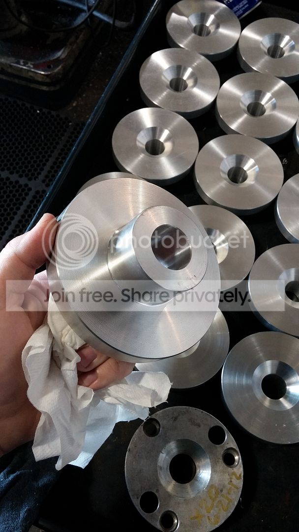

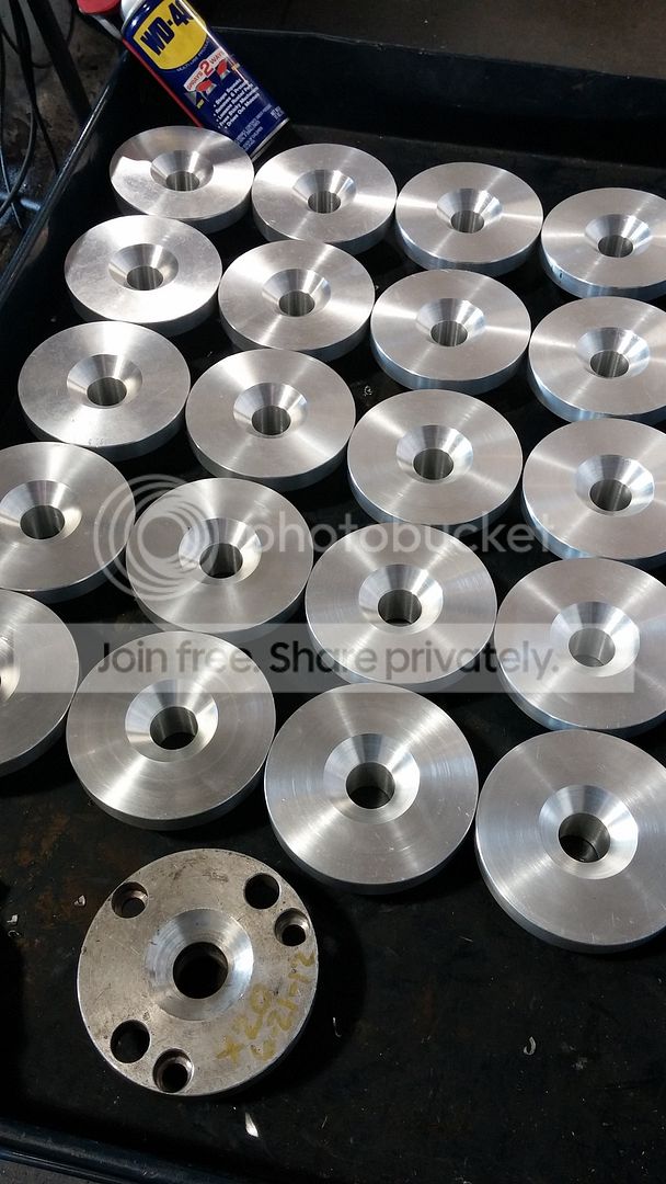

I mentioned some aluminum hubs earlier that go with those rollers I posted. I'm making a batch of twenty this week. Should take about 20 hours or so but obviously I can't always work straight through a job that lengthy without having to stop for other stuff so this has been my week long project between other stuff.
Tomorrow looks all clear though so I should have time to finish them. There's two 3/4" holes for some drive pins and a three hole metric bolt pattern that's counter-bored to recess an allen head bolt.

Oh and I finished these today but had to rush some parts out to a big customer at the end of the day. I'll deburr them and snap a pic Monday.
