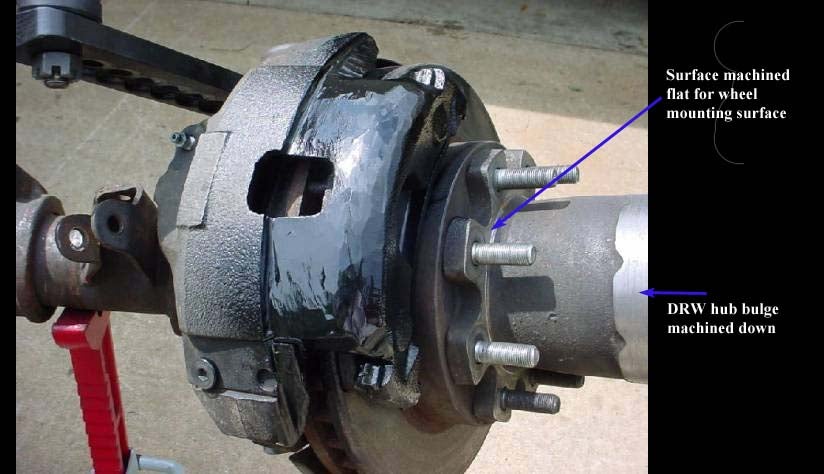

What is done to the DRW hub for the WMS? I know the DRW has 8 "tabs" where the threaded bolts go thru but without the full round flat surface like the SRW has, what have others done to make a larger contact patch for the rims to ride on?
I don't have a measurement, but as far as rims go, my spare 16.5 fits my srw hubs, but it doesn't fit my friends drw hubs milled down, sucks for him. He had his milled for the rims on his truck pretty exactly and his rims must have a bigger hole in the middle for the hub then stockers, and my spare is a factory rim...
Thats cool to see the hub so thick that the wheels just barely slide on them.
my buddy had a 1/2" ring welded to the rotor tabs then trued for the wms...
I've seen pics where people machined the tabs flat for a wms but that's obviously not strong enough. The bible suggests making a ring out of plate (3/8", I think) to weld on the outside of the tabs to create a wms.

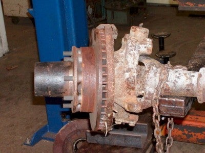

From the D60 bible on Pirate:
Stock SRW:
Suggested augmentation:
Right click, save as, then upload them to here.
