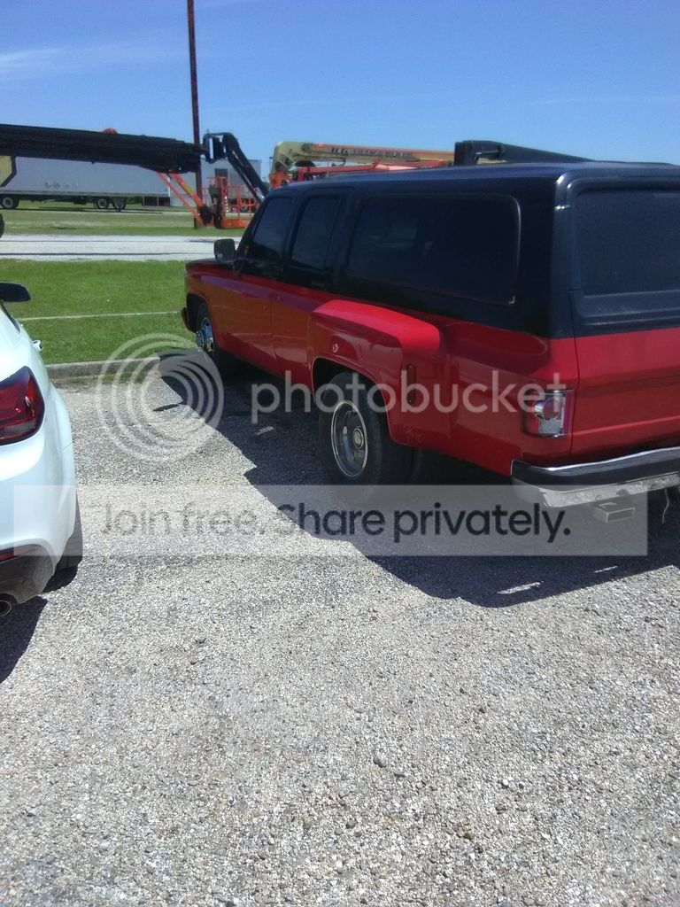

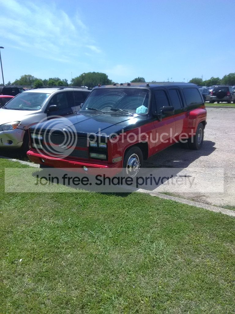

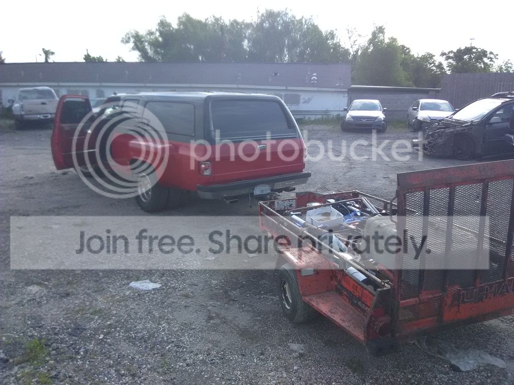

I've been wondering which transmission to go with in place of the turbo 400 thats in the 1983 Chevy Suburban Dually converted that's got a 454 Carburated motor with duall exhaust and longtube headers.
Fuel mileage is a concern some which i want either a 700r4(by taking a risk) or the heavy duty 4L80e. Which the TH400 Transmission will come out soon and due to me not wanting a few fuel mileage on the highway/interstate but also being under the speed limit of 60 to 70mph, which 55 mph with the TH400 is dangerous even on the slow lane......
Do you think i made the right decision? Besides, i might tow heavy soon or later which after im finished with the tow i would want and overdrive to get back home., and to me 700r4 no matter how its built wont last behind the 454.
4l80-e is th400 basically with o.d and lockup .this will drop you in the 800rpm range at 70 mph over the th400 .
www.usshift.com for the controller setup and harness .
few of us have it and like it . easy to hook up and use . the quick 4 unit gives you 4 shift programs to use on the fly .
and nice lookin burb :waytogo:

That's a badarse and unique burb and completely worth putting the $ and time it would take to switch. I wouldn't put up with that punk talkin smack about it much longer. Truck that old don't have to prove nothing to nobody. She's a cruizer
