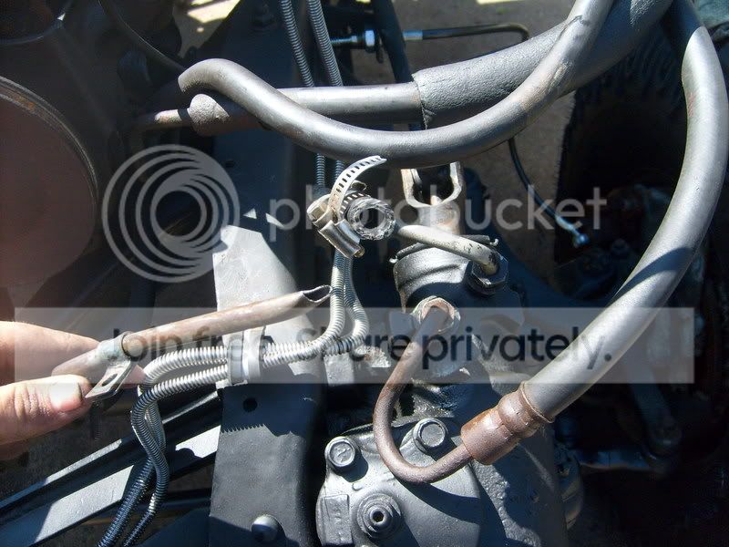

Wondering if its possible to make up a new hardline for the powersteering hose. Must be the return, since it doesn`t use crimped ends, just clamps. Also, does that one hose that is hooked up look right?
Finally hooking up the hoses for the hydroboost, and want to make sure its right. It looks different from my old setup, so I want to double check.
The line hooked up to the box now came down from the MC, so that leaves the one from the back of the pump to go to the other input on the box, is that right?
I'd just run a rubber on the return side. Its not high pressure so its ok as long as they are clamped.
