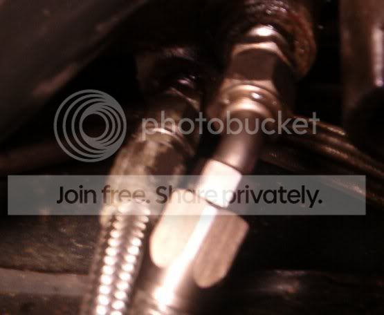

I wasn't arguing, just trying to help..
I'm just going off what it says on TCI http://www.tciauto.com/Products/TechInfo/cooler_fittings.asp
and my own experience with the 700r4... thus the pic I posted..
NPT is always a taper, I was just pointing out it stands for national pipe thread, not taper... Thus why theres also NPST...
