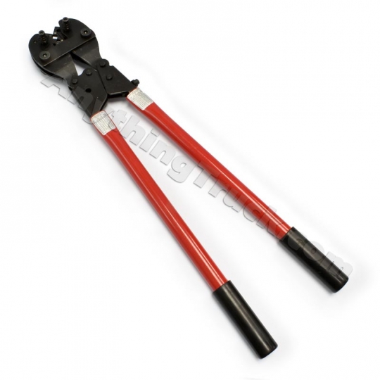

i run killer crimps, mainly cuz i have to in the boats... the CG wants mechanical connections... if you aren't sucking a ton of amps, you could solder, i have done it on my rigs in the past, but i still prefer a good mechanical crimp...... this is the crimper i run, but there are cheaper options, hammer-smashes work ok...

I saw this and was thinking about getting it.
How do you like it?
Its great and price is hard to beat plus you can use a 20-25% off coupon. I made slightly larger die using the smallest gauge and drilling a larger hole with the 2 pieces in the vice.
meh, that range is HUGE.. we get TONS of jumpers out of repo boats, some have decent cable, some are complete junk... the thickness of the jacket isn't always an accurate indicator...
