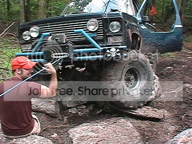

A couple pics of mine:
I drilled out 2 sets of hinges and made pins to reinstall the power doors as well.
