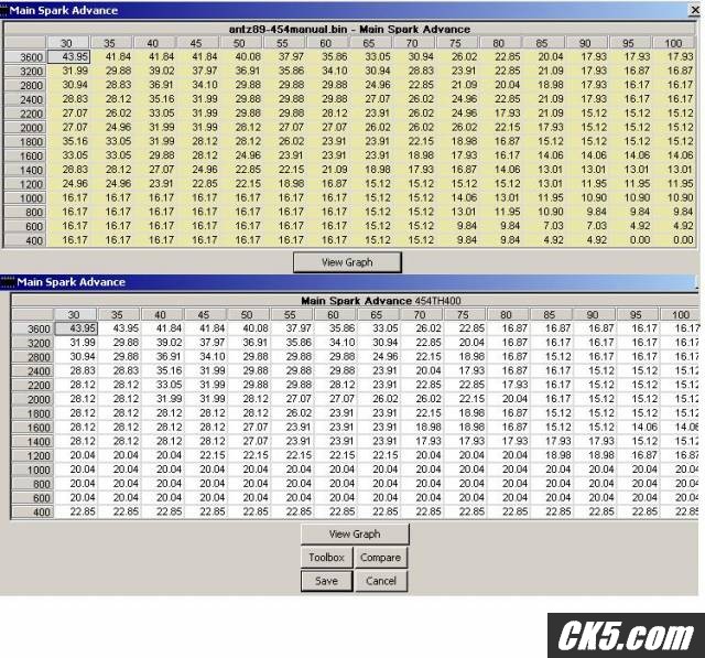

Edit: whoops. ECM. Actually will be a PCM if 4L80E, but 700R4 or manual the below image will be applicable. GM used a PCM with the 4L80E, the others were an ECM. Not interchangeable, short answer.
Here's a comparison for a 454. Not that it wont run, it almost certainly would, but unlikely it would run as intended.
