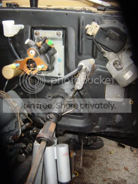

I just checked my slave with your measurements.I think maybe my slave is to high.I dont have flat area on the fire wall to move it too much.Any pics of a slave mounted on the fire wall?
Here is a pic
yours looks way too high. it should sit on that raised section near the fuse panel
those measurements were taken off a factory hydro clutch truck. so i know its right.
Thanks for the pics ,that probably whats wrong.
I'm going to lower it tommorrow:) Maybe with the different slave angle it will line up with the pedal better.
