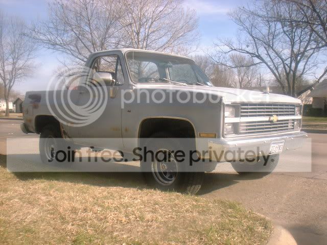

Just got done about an hour ago. Lots of little stuff kept backing stuff up. But working for 3 days as long as i could i got er done. Im so happy with it.:D
Before-
Now-

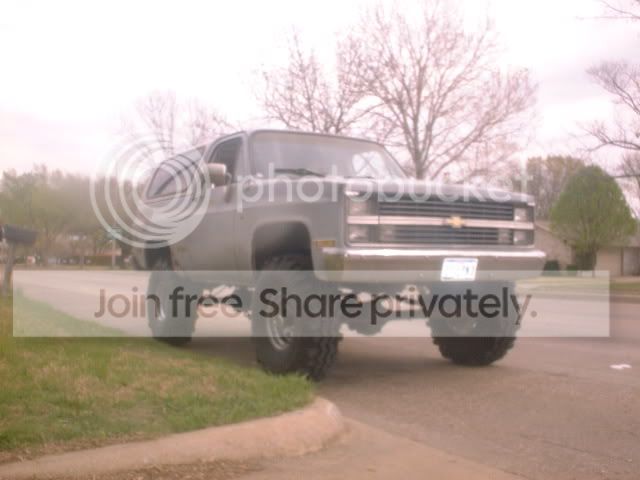

Within the next month it will be primer black and 14ff, 8 lug front, and gears will come right around then too. For now its just take it easy and have some fun. Then once money replenishes go back into it.
What kind of lift did you do? and anything else you might of done.
Put in 4" rear block, 2" add-a-leaf. Front- 6" springs, unsure of brand(bought from a friend in arkansas that parted out a blazer he had), braided stainless brake lines in front, replaced both front calipers cause bleeder valve broke in both of them. 2 new rotors(one was "slotted" from somene running it to metal on metal then replacing pads), rear bearing seals.
I might put in spacers between frame and tcase crossmember to help angles. Will start searching for a 14ff for the rear and save for gear front along with 8 lugging the front. And paint will happen within the next month cause that is a must with the rust.
