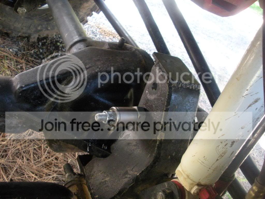

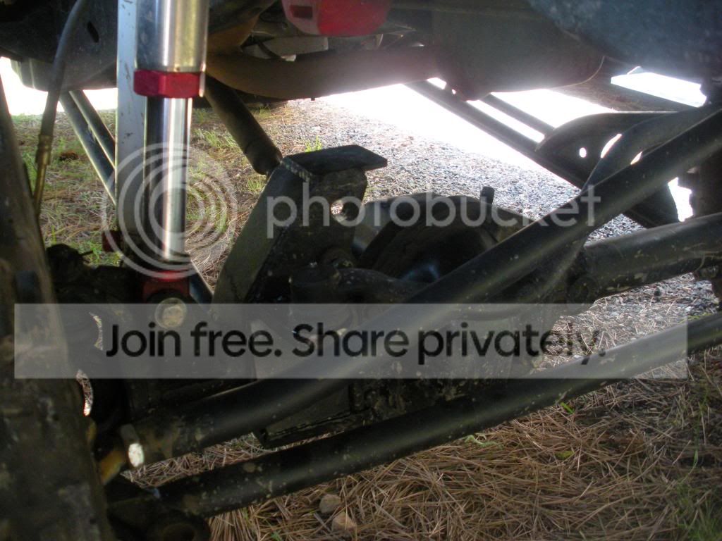

Overall the trails were fairly easy and I am really impressed with the new loc-right in the front of the blazer. Eddie took on the rock garden in his S-10 and did really well. A couple miles down the road he realized his steering was acting funny, After checking it out he had started to tear his track-bar off the axle. As luck would have it we noticed the damage next to thee parks boundry right next to a forest service road gate and a sherriff just happend to be driving by, we flagged him down and he opened the gate up for us to the nice flat road to limp his truck back to the campground.

We got back to camp and started to look for some solutions to get his truck somewhat roadworthy, The ratchet strap we used to get off the trail wasnt gonna cut it. Ends up that a 1972 Blazer body bolt was up to the task, After drilling out a hole and finding a couple spacers for the super long bolt, we got it put back together, He drove 35mph back home the 65miles.
