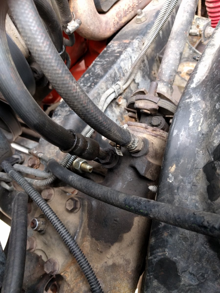

Hoping to ask your opinion on this... here's the short sequence of events:
  1. Drove the K5 to Winter Park on Saturday. It did just fine. Parked it in the garage when I got home.
  2. Went out to the garage Sunday to move the Blazer and found a small pool of yellow fluid on the floor. Based on the location beneath the truck, I guessed that it was either brake fluid or power steering fluid.
  3. Parked the Blazer out on the street because I had to do some other work on my daily.
  4. Checked the Blazer today. No new fluid puddles beneath it from what I could tell. Popped open the hood and looked at the master cylinder. Looked fine.
  5. Took a look at the power steering reservoir and I was high on fluid (well above cold line).

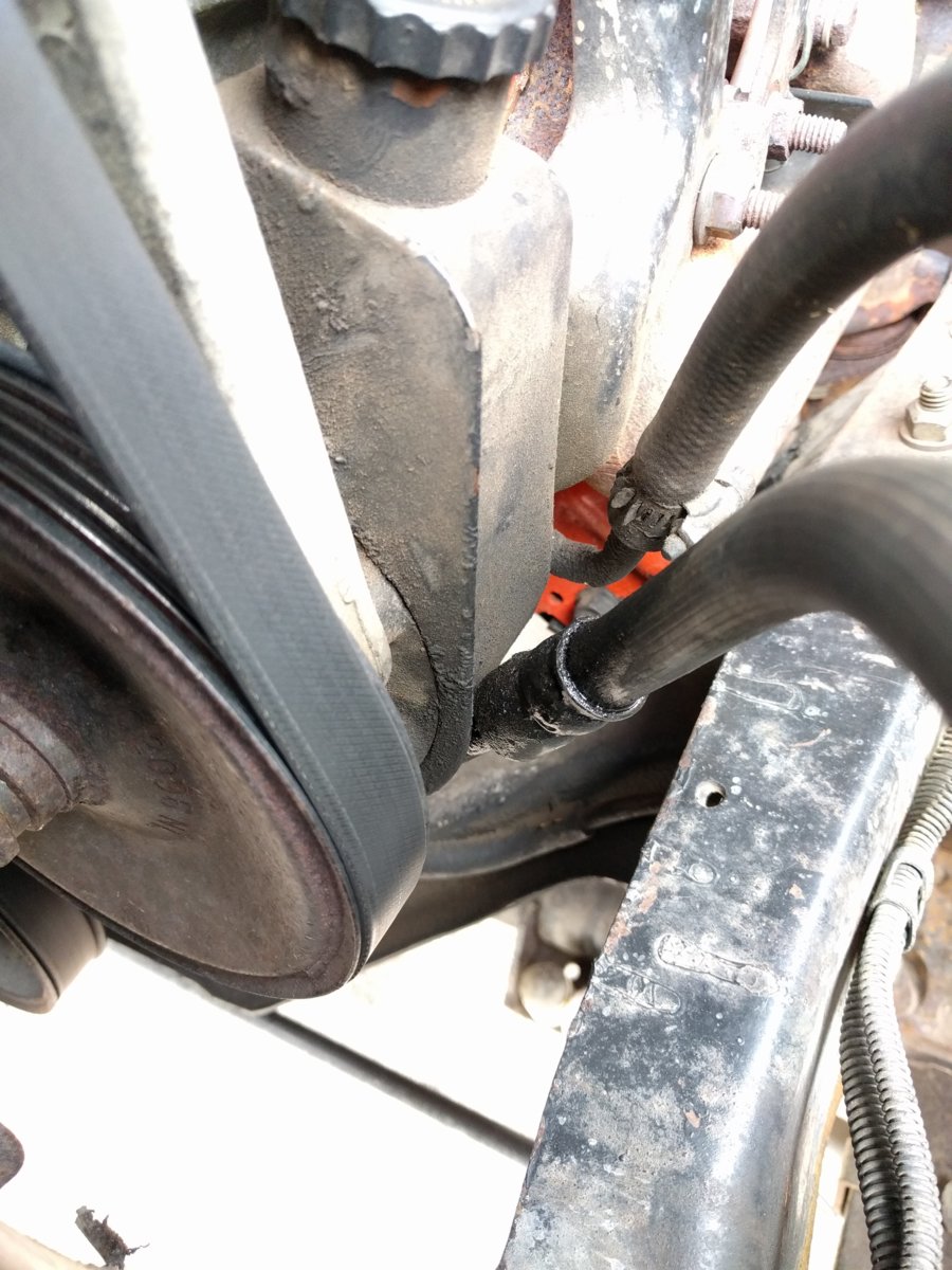

  6. Took a look at the power steering box and took these two pictures:
Both ends of that one hose were visibly wet / stained from fluid. I am hoping that I had a little too much PS fluid in the system. When driving to and from the mountains, it got real hot and overflowed a little bit. The hoses looked fine, but I didn't look that closely.
Does that sound possible? Anything else I should be sure to check?
Thanks all.

P/S fluid is usually red ATF or a brownish color,Coolant could look yellow if it was mixed with different brands or the red stuff GM used in late model vehicles,and motor oil is a brownish-yellow color..
It could be your P/S pump just peuked out some excess fluid after it warmed up and expanded..

Yeah man, I'm thinking that's what happened. Had too much in there and it threw some up. Hopefully it didn't cause harm to my hoses.
Nahh,I doubt it would...the "tank" has no real pressure,not enough to harm the hoses anyways..
