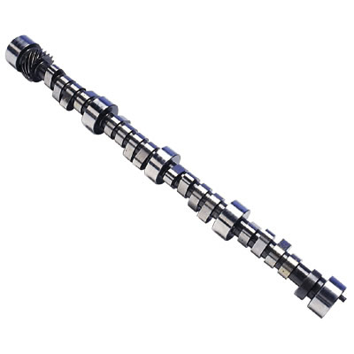

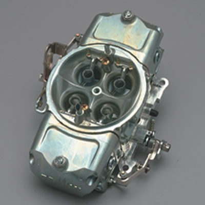

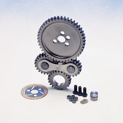

It'll be atleast a year befor I will have the $$$ saved up to get one, but I think a 327 would be alot of fun. I'm thinking Comp cams 292 magnum cam, Pete Jackson gear drive (Machined for more noise) Dart Machinery's "Kool-can" intake manifold and a Barry Grant 750cfm Demon carb with mechanical secondarys. Hooker headers, 2.5" dual exhaust with a pair of Flowmasters 40's. /forums/images/graemlins/thumb.gif /forums/images/graemlins/whistling.gif
I'd like to have anywhere from 9.5 to 1 to 10 to 1 compression. I always use 91 or higher octane pump gas.

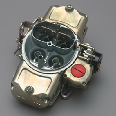

After talking to the tech staff at Barry Grant, they recomended this carb for the motor I plan on building sometime over the next few years. It's a 650cfm Mighty Demon.
Mechanical secondarys !!!! /forums/images/graemlins/waytogo.gif
[ QUOTE ]
[/ QUOTE ]
You gonna run an Auto with high stall and steep rear gears or stick ? Thats a nice carb. /forums/images/graemlins/waytogo.gif
[ QUOTE ]
TH350 with a TCI 3000 rpm stall, and 3.42's or lower.
[/ QUOTE ]
Perfect /forums/images/graemlins/waytogo.gif

ran the numbers and my initial hunch seemed right. 292H is just too much cam for that setup unless you get some really nice heads. Even then the 286H will make some more torque and horsepower throughout the powerband. I ran the numbers with standard 881 Chevy heads, then again with AFR 190 heads. The 881s are around 330 horsepower, the AFRs over 400, but thats another deal. With both sets of heads the 286H made more power. I didn't see any mention of heads in all this. All those parts you chose are really nice but if you are going to smog heads with big chambers the compression you want will be a little hard to get, the power won't be great either.
[ QUOTE ]
[/ QUOTE ] Sorry, if I went all out, I'd probley use the World Products Dart 2 Sportsman heads.
