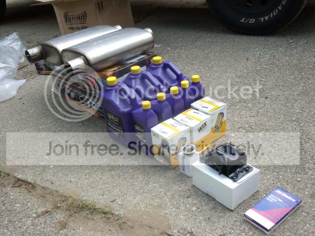

MMMMM royal purple :D
Broke my motor in with RP break in, and bought lots of extra for later :thumb:
