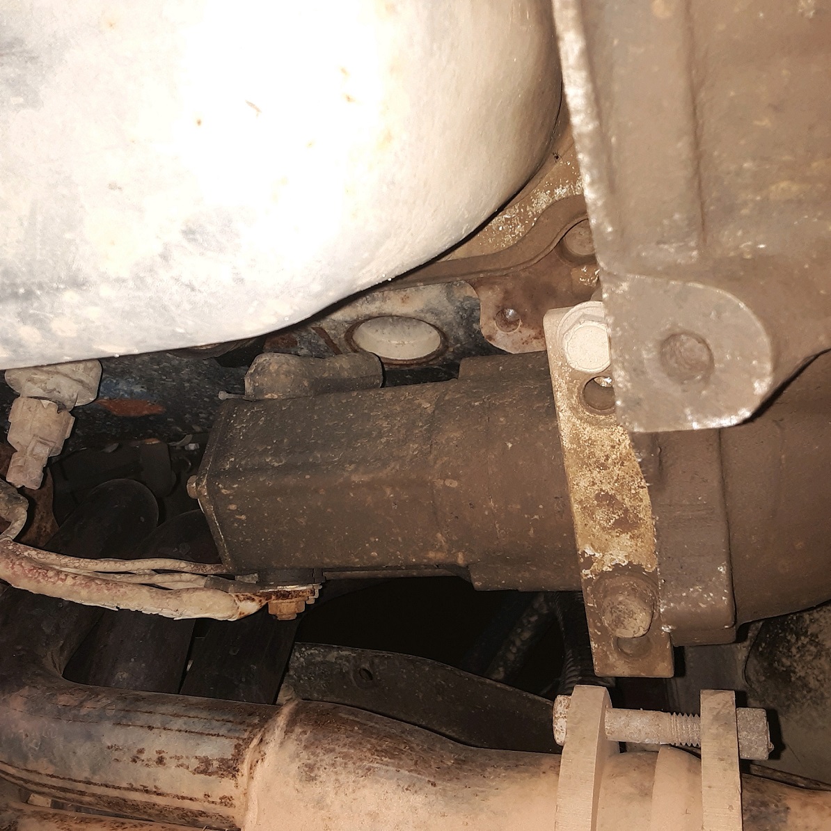

I mean look at this beauty! Powermaster that had been used on a circle track car before I got it, obviously immaculately taken care of, to include my amazing battery cables.
full
It's six years since I installed it, no idea how old it actually was. Truck is minimally used, and while things wear out with usage, sitting for long periods (like mine does) is very hard on stuff too. But no issues. Always cranks. Hot or cold.
full
That looks to be a Nippendenso starter. They are definitely good units. It is the same as what was used an a bunch of 4B Cummins engines. The slightly larger version was for the 6B engines. Also used on other diesel engines.
Power Master uses those and Hitachi motors for their starters.
