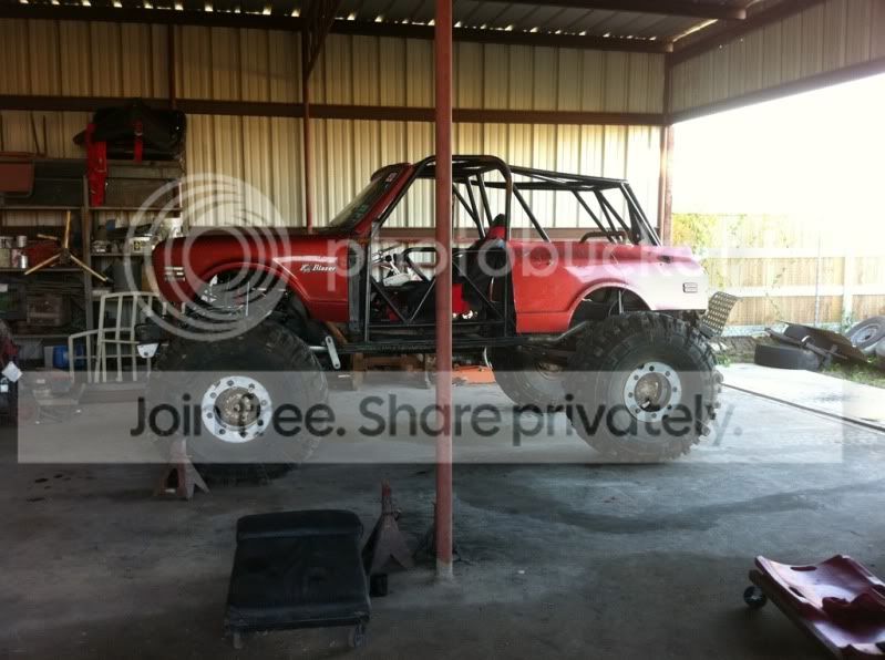

Stock 52s up front, 3" tcis in the rear with 4" flip...sits sorta low for what it is.
I think this thread needs more photos.
If nothing else, to see who's got some rockwells on their rides :)
