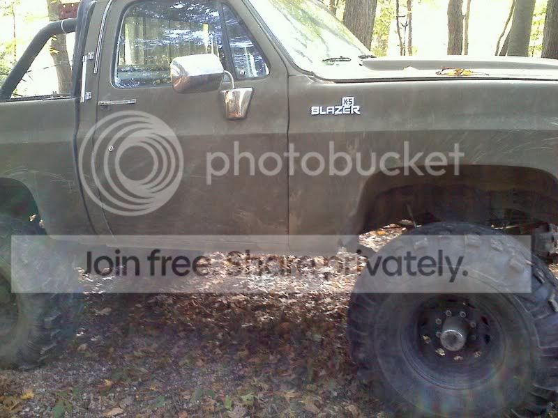

here is an example of how 8" looks like with 40's
id say a minimum of 6" lift...Minimum of 1 ton axles with 4.88 gears. Must clearance the fenders...
yeah, but nothing came with 4.88 IIRC, so if re-gearing is necessary, go right to 5.38 or more. 6" and a sawzall :)
