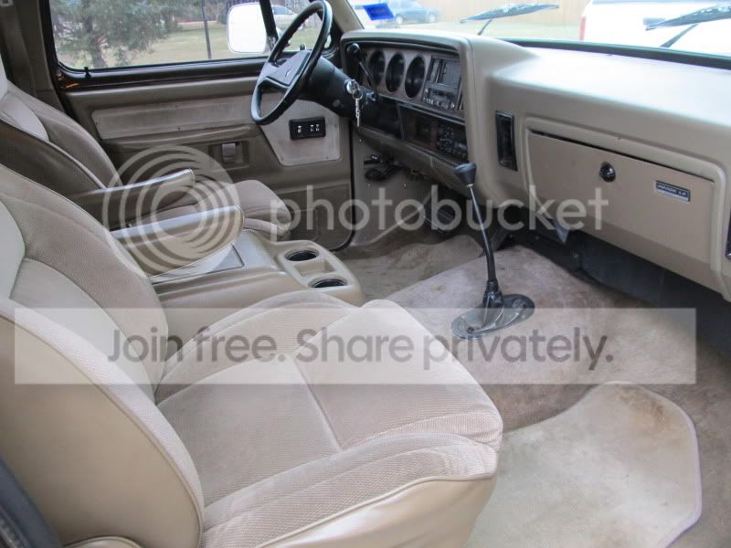

I am thinking of addressing this same thing on my Suburban with a NP241 when I do the NV4500 swap as I prefer the shift lever to stand more upright like the NP205 shifters do. The route I was planning to look into was using a shifter assembly from an early 80’s to early 90’s Dodge truck or Ramcharger. They used the same basic transfercases as GM anyway where I bet the GM shifter stick could be used on a Dodge shifter assembly. Actually, the Dodge stick is decent looking where I wouldn't mind running the entire Dodge shifter and stick but with a GM knob.
This is how the Dodge 208 and 241 shifters look. Bet this could be retrofitted into a GM very easily. One of us should try this and see how hard it is to make work.

that looks good, IMO....may go on the "to do" list :waytogo:
So where is the pivot point on the Dodge setup? The pictured one looks more like a 205 setup where the pivot is cast into the adapter, and nothing is bolted to the body.

Have you taken yours apart yet? There's really nothing to them -
Get some round stock and make it how you want.
No, the Dodge’s are just like the GM 208/241 shifters where there is actually a shifter assembly in the floor, the Dodge version has the assembly mounted under the turtle shell. These are totally different than a 205 and more like our 208/241 setups which is why I suggested it in the first place :rolleyes:
Here is a guy that used a Dodge shifter in a GM, albeit the shifter is out of a ’94 and later Dodge. Scroll down to post #115. Still pretty much the same shifter assembly configuration as the older Dodge shifters with the pivot built into the shifter assembly.
That's a 208 shifter in the picture. The 205 shifter is a lot shorter. It looks very similar though.
The 205 has a pivot on the adapter like a gm.
