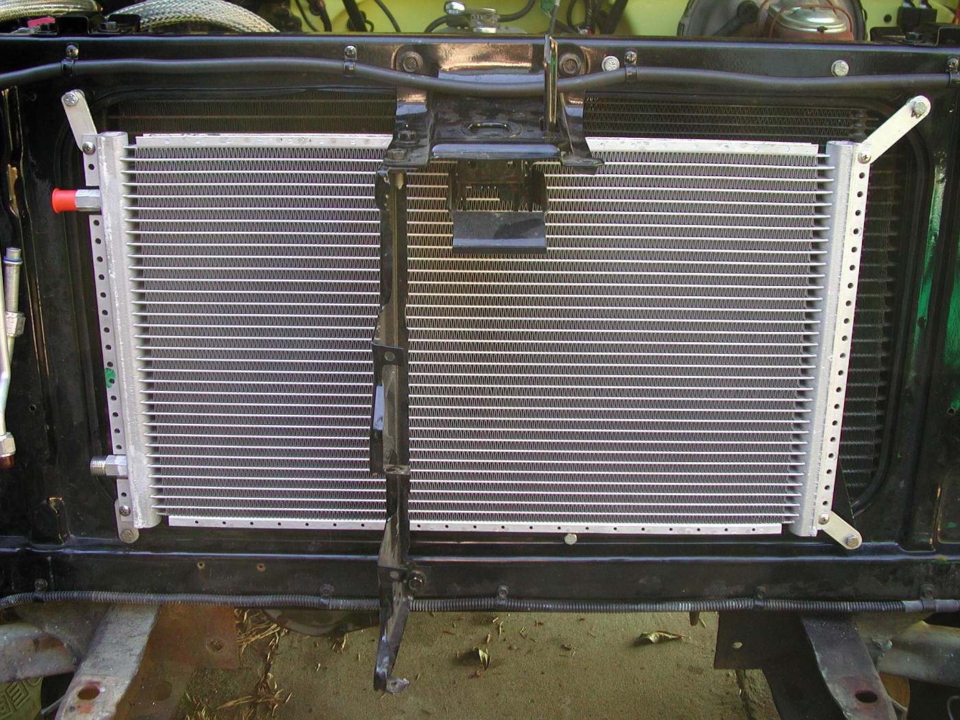

Has anyone added the monster 30'' x 19'' par flow condensor to thier burb?After the 134 change and new compressor it just won't cool.Most common complaint is from the single flow condessor.Any info? Mine is going in tomorrow.

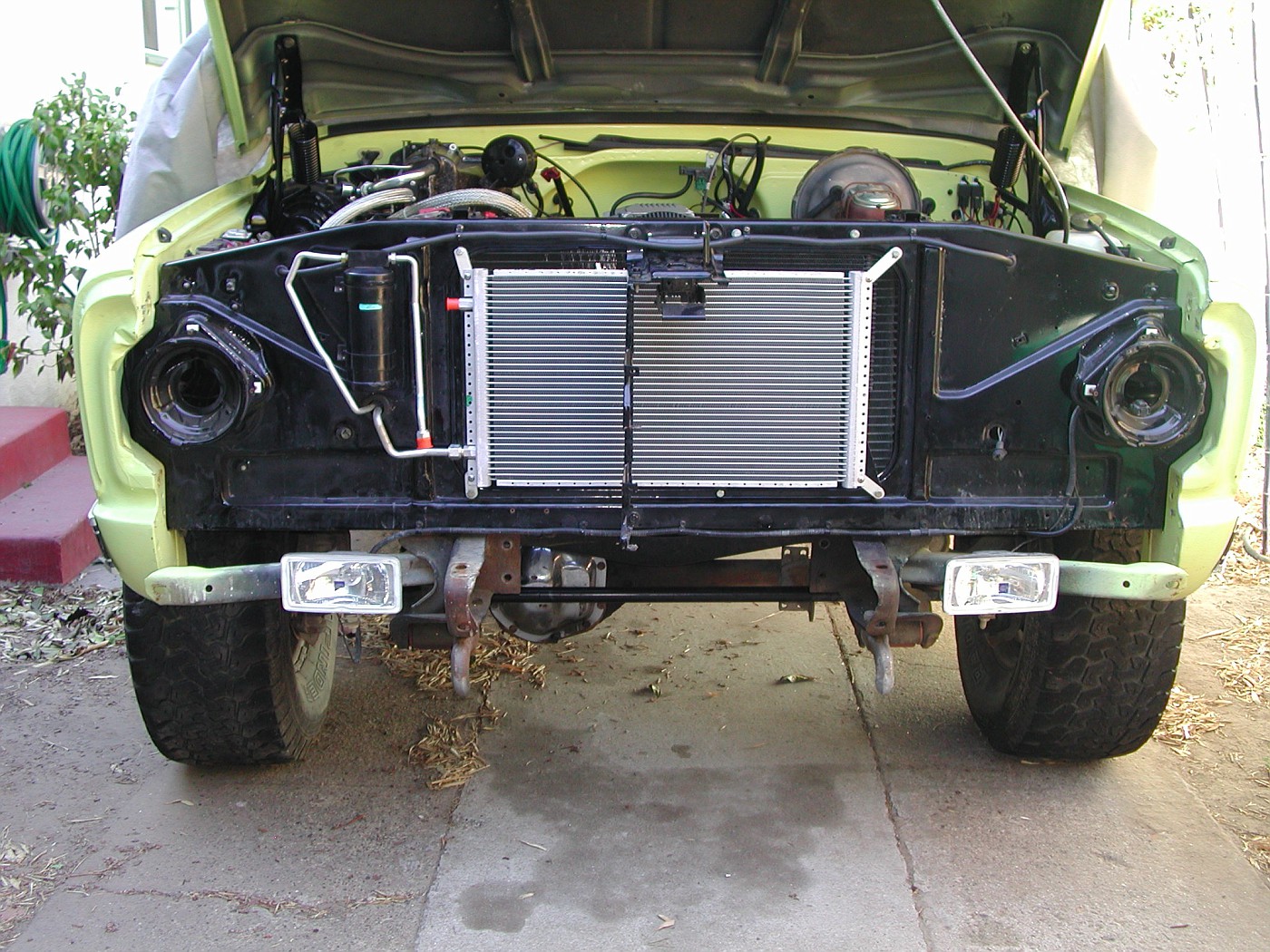

When I converted my Blazer(1st gen) over to 134 I toyed with putting in a parallel flow condensor but used my orig condensor.Got the vent temps down to about 44deg F. ...not bad.
About 1 month later my evap. core blew so I had to redo the system and opted then to add P/F condensor.
My vent temps are now arounf the 40-42 degree mark.
I only used the 14"X26.5" as I am a little tight for space.
I think overall it's slightly bigger than the factory one.
