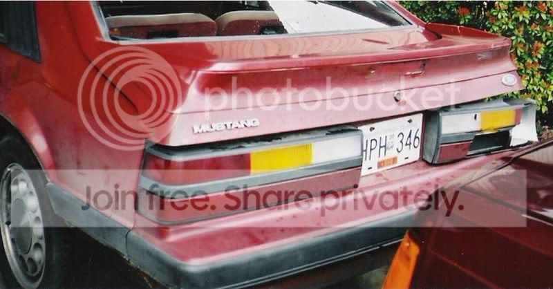

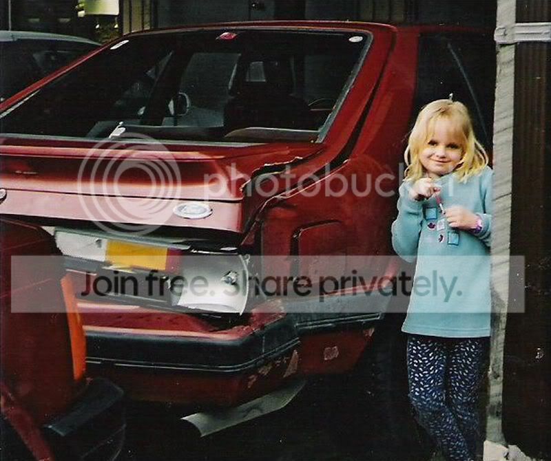

Damage pic's of the '86 :doah:
Notice how the hatch is completely shifted over. The hinges aren't broken...

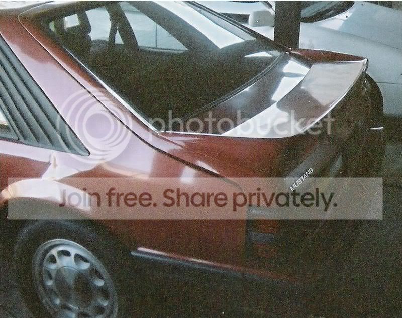

This is the 'bad IMO. Proof that the body is pretty tweaked. This is the drivers side which hit nothing and has never been hit.

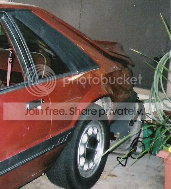

Another view...
The wrinkle, crease over the rear wheelwell tells the story, the whole rear part of the car is pushed over...although it still drives and tracks normally. :screwy:
