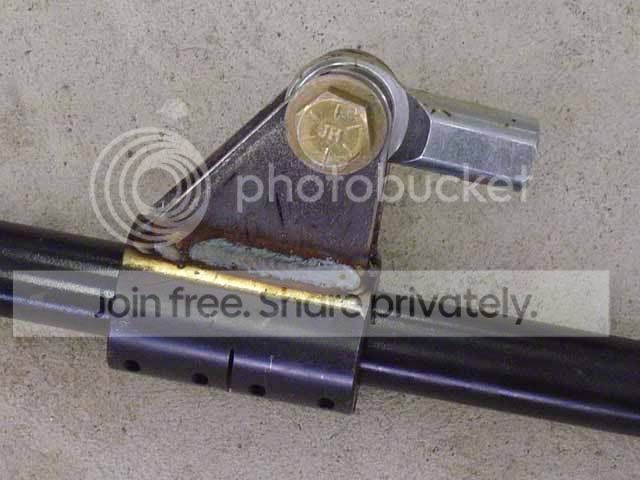

Here is mine. Tube of steel threaded for bolt that goes thru ram. Tie rod has triangular tab with steel cylinder for other end.
Works so far, it was on the axles when I bought them.

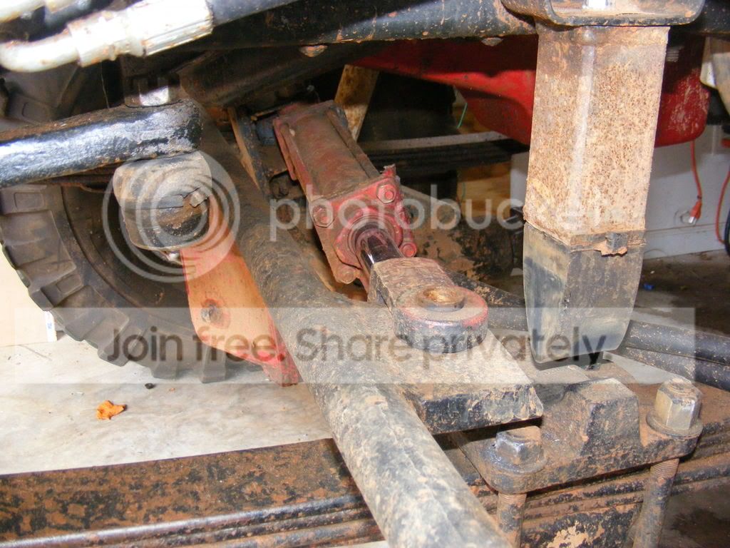

1-tonmudder that's what I was thinkin for the spring plate. I'm assuming it's been good because you posted it. I was a little worried it wouldn't be beefy enough. I already made somethin similar a couple of years ago for my dampener.
The only thing is to use the poly-fil nuts.I didnt and they get a little loose somtimes.I should have centered it a little better so I can get the cyl bolt out without droppin the u-bolt.

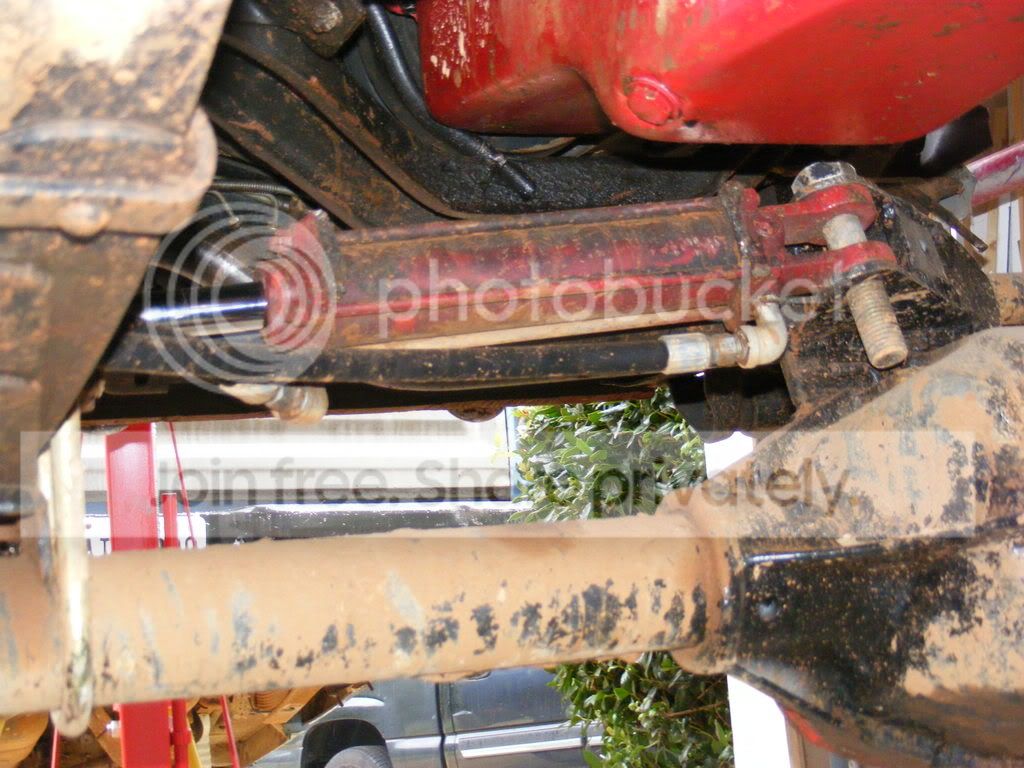

Greg72 used this on his.
I wanted to use one on mine but I didnt have the clearance between my tierod and drag link.Im runnin hi-steer and X-over and my front axle is moved forward 1inch.
