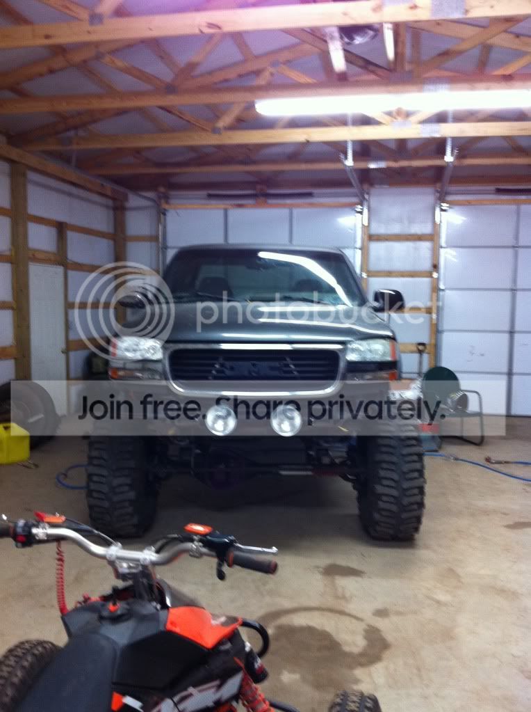

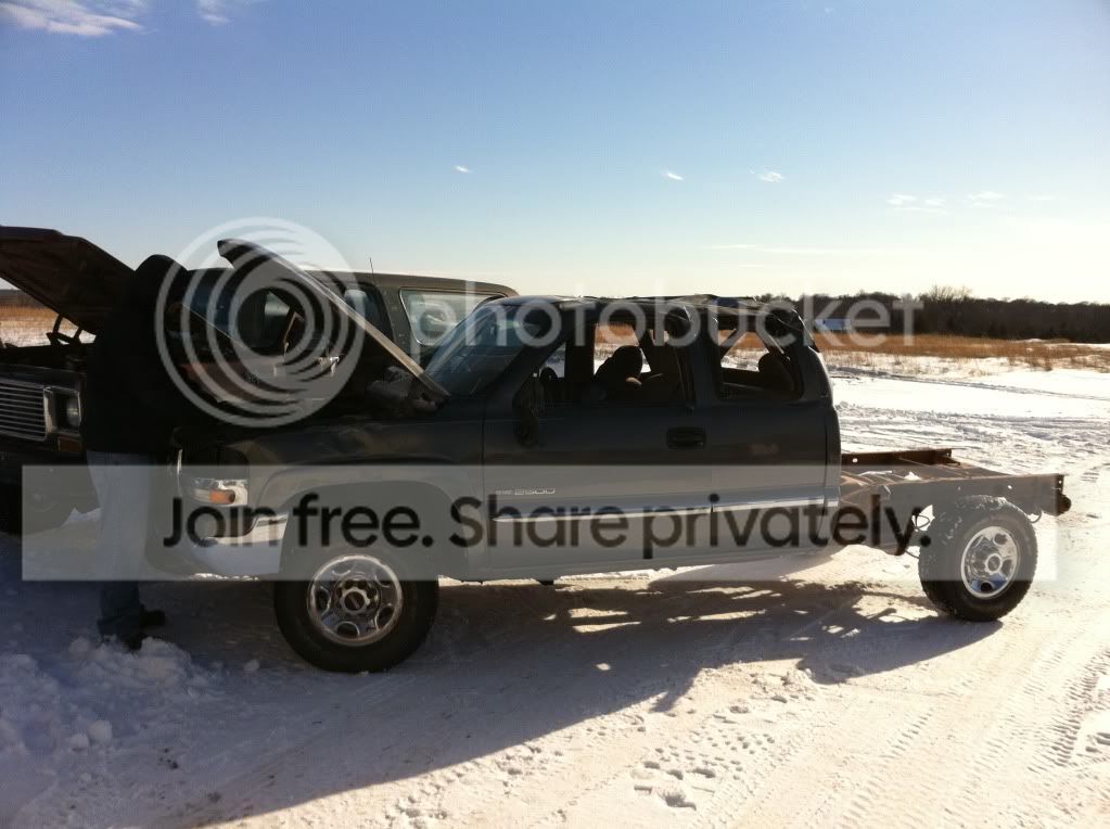

Here's a few pics, just because I always like pictures when I read someone elses paragraph.
I'm on the hunt for a new cab. Probably going to get a flat bed.
Hood is straight, front fenders arent too bad.
Looking better

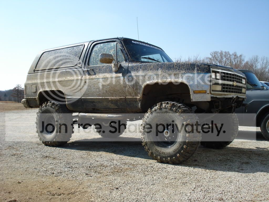

And one of the Blazer
