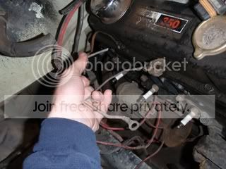

Workin on putting a TBI setup on a carb 350. These three plugs I am curious about.
I believe these all go to the starter. Can you tell me which terminals they go to?

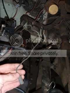

I believe this is for the temperature sender. Is that correct?

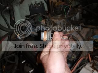

Where does this go??????

You got the first two right, the last one not sure. Maybe smog pump, it's a weatherpack and has three wires, not A/C, maybe something that plugs on the firewall??
The wire with the big eyelet bolts to the battery terminal on starter. Second wire with plastic connector goes to the knock sensor. Third green wire might be temp sender wire???. Last connector looks like EVRV (EGR) solenoid maybe.
