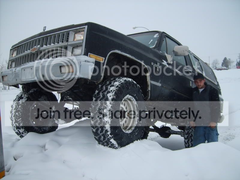

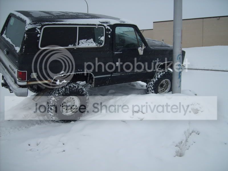

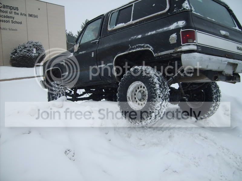

THANKS I WILL DO THAT TOMORROW...ITS WIERD CUZ WHEN I DROVE IT TO WORK THIS MORNIG EVERY THING WAS FINE AND IT SHIFTED THROUGH ALL GEARS...I DROVE IT ABOUT 15 MILES ON MY LUNCH AND IT WAS STILL FINE. I GOT IN IT AFTER WORK TO DRIVE HOME AND GOT OUT ON THE MAIN STREET AND IT WOULDNT SHIFT???? IT CRAZY...... heres a pic of my truck

Thanks For All Of Your Help What Do You Think Of The Truck.. I Have A 14bff W/ 4:56 Gears In The Garage Waiting To Be Put In Still Hunting For A 60 For The Front

I think your shift key is stuck more than your tranny =))
With tires that big, the 14bff wil be useful ... and the 4.56:1 gears will make her MUCH happier.
I'd make a crack about how *real* Blazers have no top ... but that white stuff on the ground makes me think otherwise :haha:
Nah, she looks good ... it never ends, and yours may end up looking like mine if you're not careful. Mine has gone from stock (well, 33"s in this pic)
