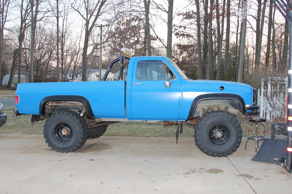

Ok so my fullsize spare (40x17x16.5 hawg) just flops around my bed... I want to mount it and also I have a hilift jack that I want to mount..
so I theoretically could just mount it to the floor with long bolts and nuts through lug holes and put metal enforcement under bed....
OR
I could mount my spare to the rollbar (not a true rollbar but more of a lightbar)...
then no clue where to put hilift jack...
looking for thoughts/considerations...
only handy pic of light bar... I have to take it off and sand/paint anyway but was thinking could bolt/weld X bars and put tire into middle of it...
Plus3 by Jeffrey Riggs, on Flickr

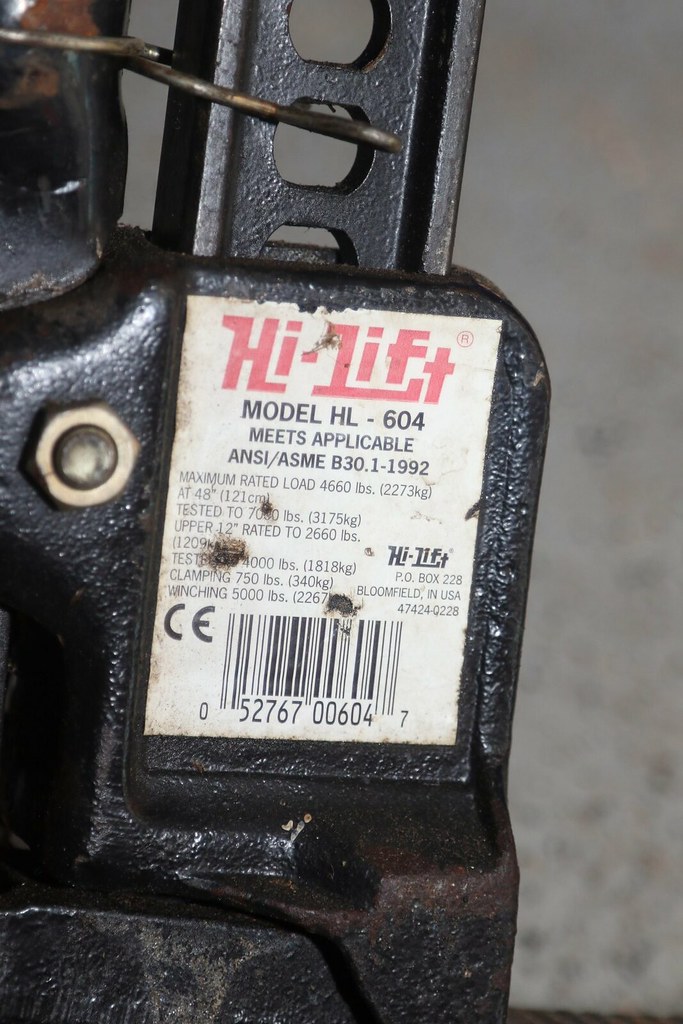

So i bought mine so long ago from pepboys... i dont think its a "hilift" but a farm jack.... now i gotta look....
so I found this... gonna be a baseline for my thought.. but I'm thinking of having it off the bed... and a v under for the tire to sit into that will help relieve some weight...
