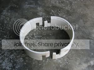

got one mounted four more to go, I ended up cutting the insert to get it in the tire, next to impossible if you don't. tires look too small

they are the pvc inserts, but the hummer tires are a pretty heavy tire not near as flexible as a tsl, even cutting them and getting them together inside was a challange, but now I know how to do it, I cut them so they interlock like a puzzle, I was telling my buddy who helped me put them in that if the tire was a tsl and was bigger it would be a lot easier

To get the PVC inserts inside hummer tires, I had to soap everything up and set the tire on the insert (sideways) and then jump repeatedly on the tire as hard as I could to get the insert into the tire. Then it was on to prybars and long pipes to rotate the insert until it was between the two beads. It can be done, like they say, but they don't tell you what a huge pain it is.

That is the reason I am seriously thinking about getting the Mag inserts and cutting them down. Two piece already.

I bet it's a lot easier to cut the pvc, it only took me about 5 min to do, this is what I copied
