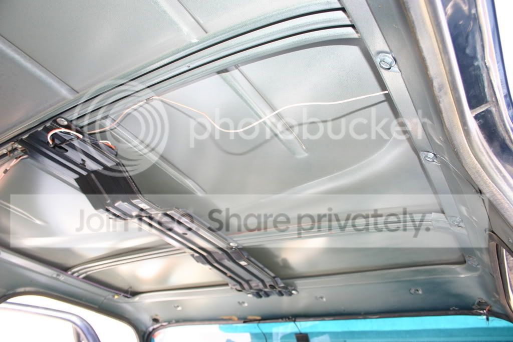

I didn't think so, except for the lip that runs around the front and sides. At least it didn't look double-walled when I did the headliner. The whole roof followed the indents and curves of the outside perfectly. Like this:
I might be able to hit that beam though. I forgot it was there until I dug up this pic.
Yeah just build a mounting cage for it that fastens to places you can bolt (like the roof supports).
yeah. that frame is perfect to work off..
