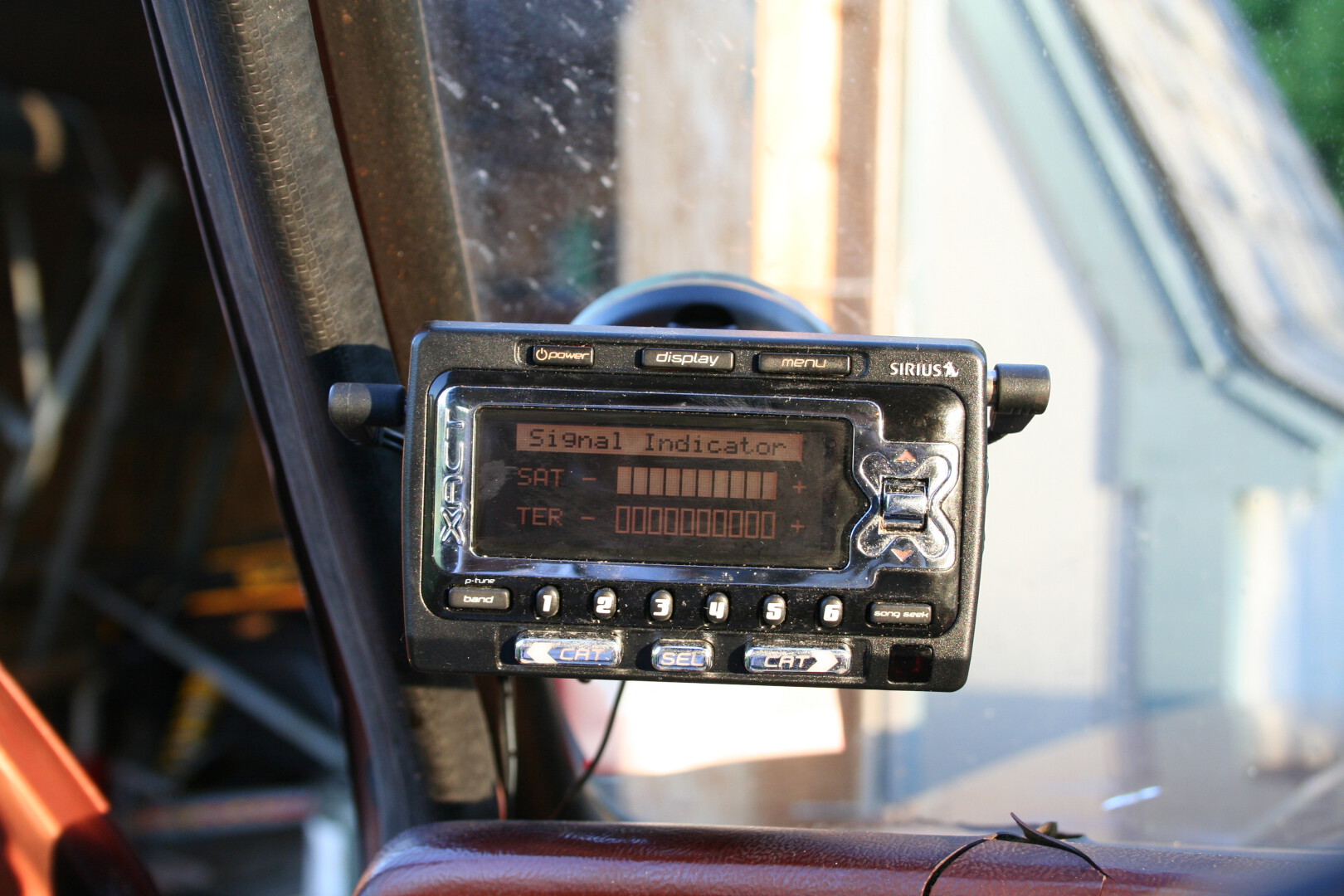

I made some tests with a piece of line-xed fiberglass I cut out from my side panel (10" diamter hole I cut for the sub-woofer).
I took the piece out to my C10 where the sat radio is now and had my wife watch the signal meter while I held the piece over the sat. antenna.
Result: Little effect. I held it about 1/4" above it so it was bloked completely, still 10 bars. Moved it around trying to find where the sirius satellite was at that time to try and directionally block the signal, got it down to 9 bars from 10, but thats all I could do.
I think it just might work underneath the fiberglass shell.
The shell is a bit thicker than the piece I had though..so I think more tests are in order. Once the lawn dries out (been raining here very hard) I might drive the C10 in the back to where the hardtop is and take the antenna and put it underneath the top.
I have since took possesion of my Sirius unit . My antenna is on the metal roof facing forward ( so I guess according to the manual I am driving backwards everywhere LOL ) . With the wire under my windshield gasket . Coming in through the fender and in the hole where the power windows wiring comes out . Can't see the wires it rocks :thumb:
Proof positive. No effect!!
Drove the C10 into the back. Placed the antenna as far under as I could get it. Zero effect. Still 10 bars.
Proof positive. K5 Fiberglass top, no effect on Sirius Satellite radio signal. I'd imagine XM is same.
