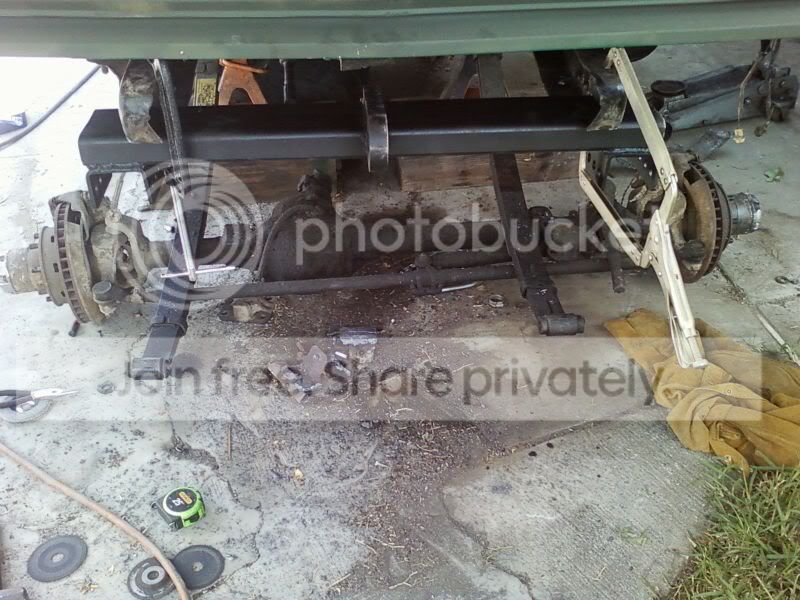

Mounted mine like this.
Cupped the square tube to the frame and gusseted, and cupped the spring perches to the square tube and gusseted

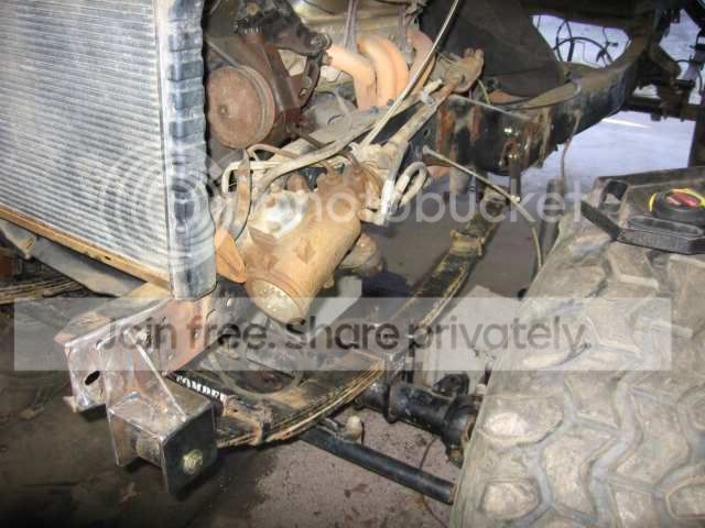

A guy on Nor Cal Offroad built these. Lowers the front eye down an inch or two. I don't remember.

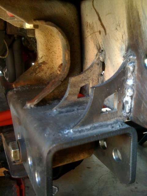

well i would like to use the hangers i bought but i will use the idea in the pic with the hangers. that will work just fine. Thanks

a few from pirate, on an older burb.... Remember these are all in the process of being done so their not the final design.
the pic right about this post is what im going to do, but im going to do it with the web gussets. i already ordered them. pics to come. thank you for the pic that helps tons!
No prob, there are lots more to show. Some real beafy ideas to go from, i just searched 52s and found them.
